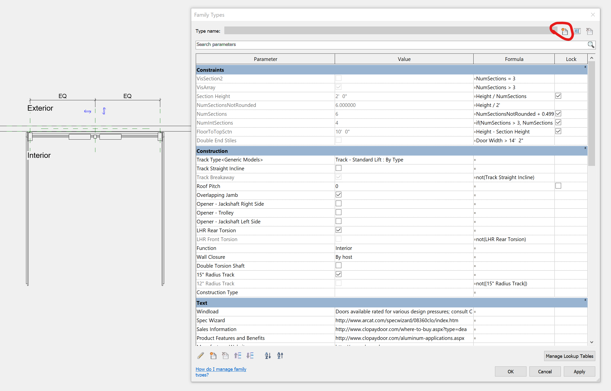

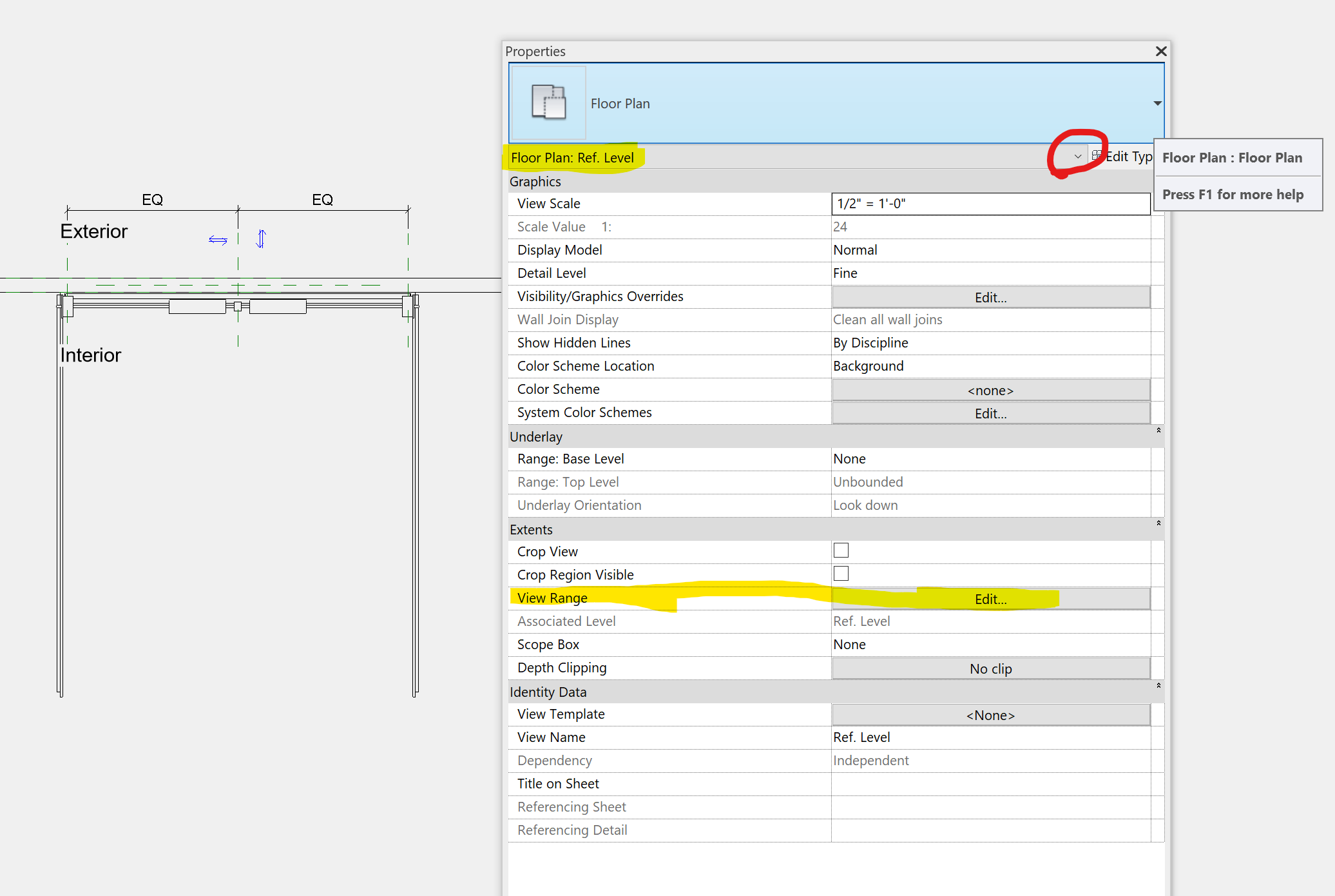

Anyone use the garage doors that Cloplay offers? There is no type catalog with them and I can't figure out how to make the differnet types as the options are grayed out. Also the overhead rails don't show up in the family when in the reference view but when inserted in the model they show up.

@1 Just click on 'New Types' button in the Family Types dialog box. See picture.
@2 Tracks are above the cut plane in the family. See picture - should be self explanatory.
