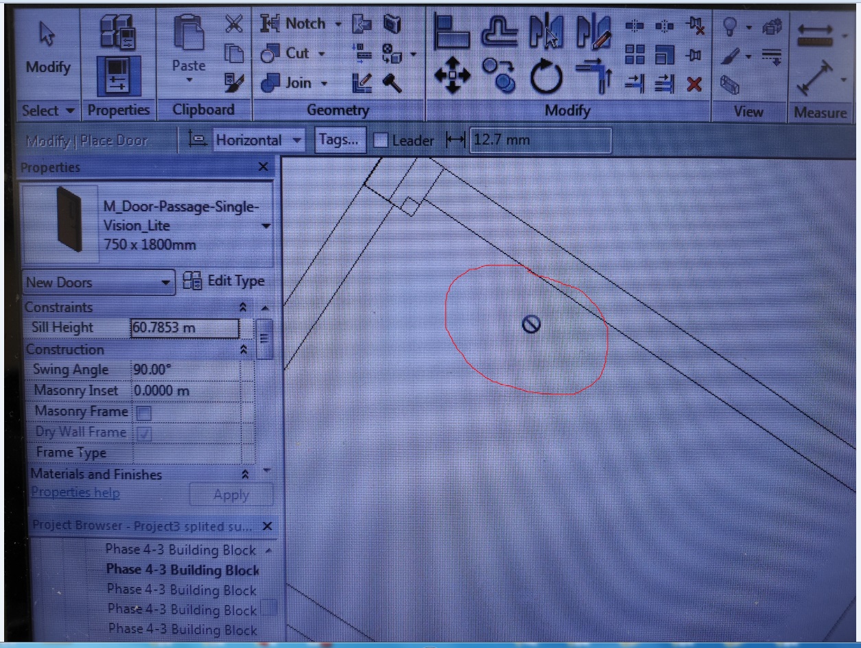

When I try to insert door to wall(upper roof level),it shows me a block symbol.
But Revit only allows me to insert door to wall in lower level.
Please help
Thu, Oct 8, 2020 at 6:46:39 AM | Can't insert door to wall
Look at your sill height.  60m - really?
Are you working on the floor plan level where you want that door?
