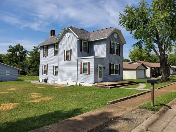

I am using Revit 2019 and trying to do a roof.  It is a gable roof with a small hip at the top.

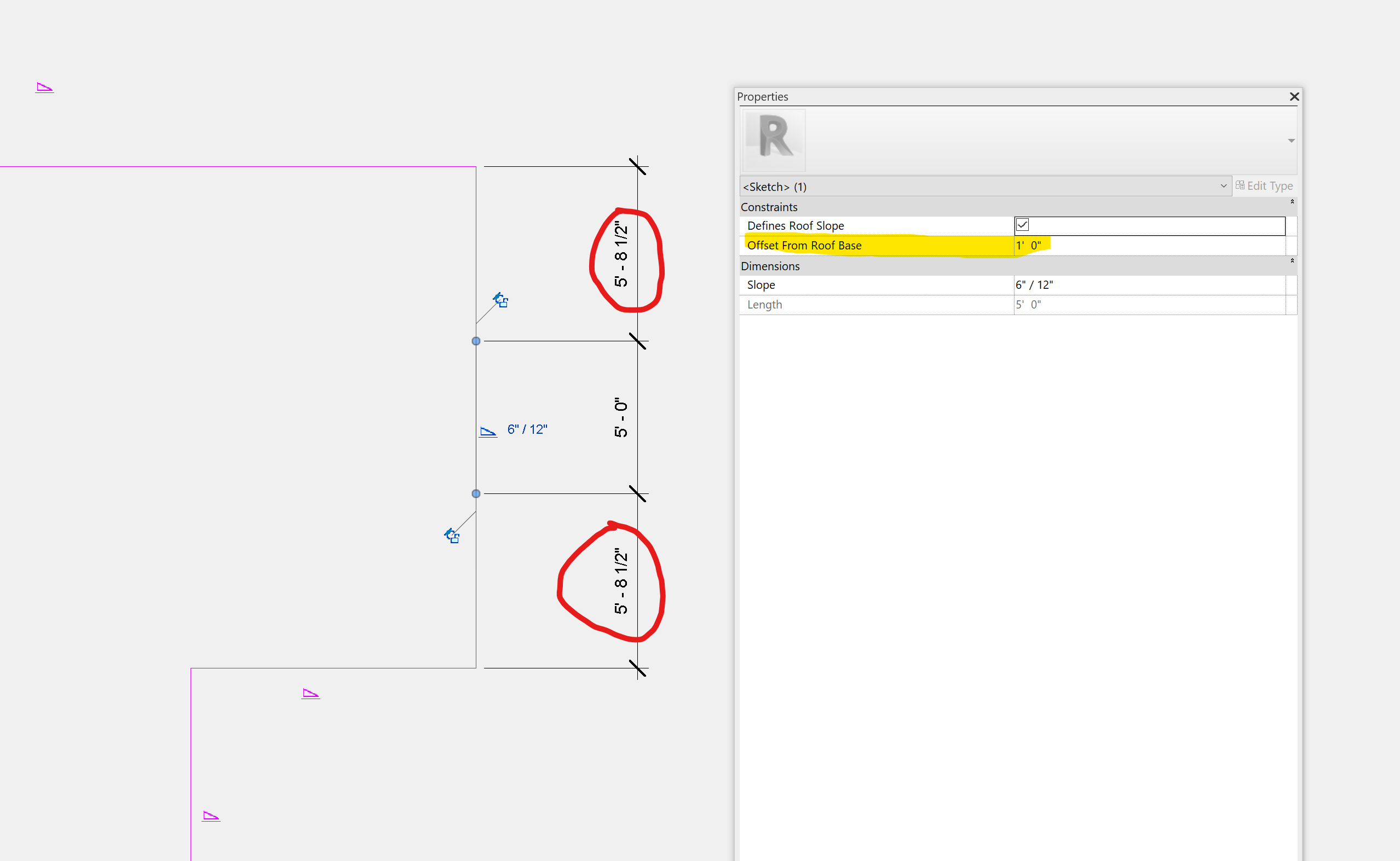

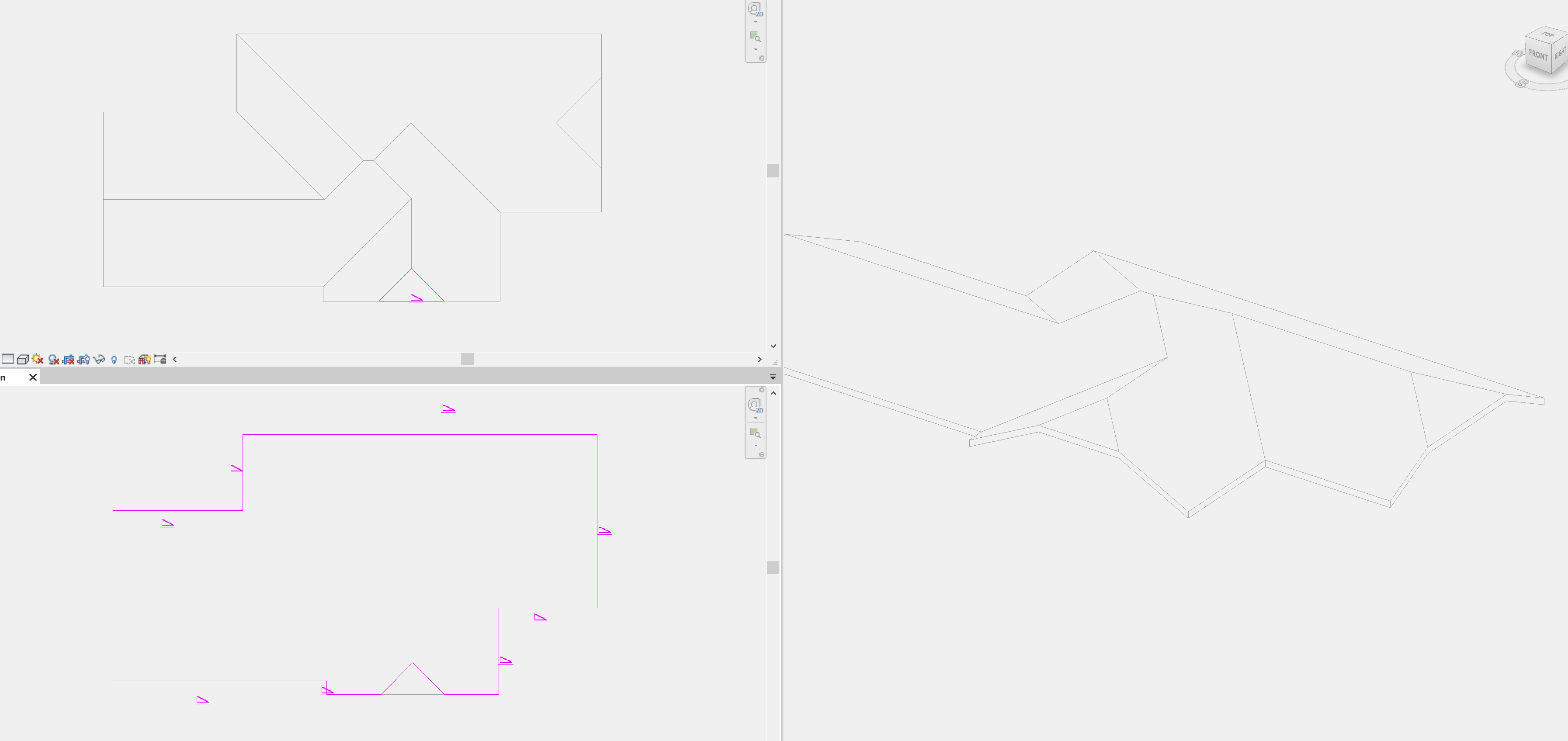

For some reason, the hip is not working.  Even though I have broken the hip to make it smaller.  It still shows up as a full hip.  Where am I going wrong.  Attached is the roof file.  Any guidence would be appreciated.  Thanks

Yes.  At the Gable end with the small hip.  I have the two outside lines as "No defined slope".  The center were the hip is.  Has a defined slope of 6/12.

For starters, make two side line segments equal length and apply an offset for the middle segment (pic 1).
If you make those segments too short or the offset too high, Revit could complain. In that case try the option with two roofs (pic 2).

Thank you very much.  Your image was very helpful.

Attached is the part of the roof I was needing to make.  Thanks again.
