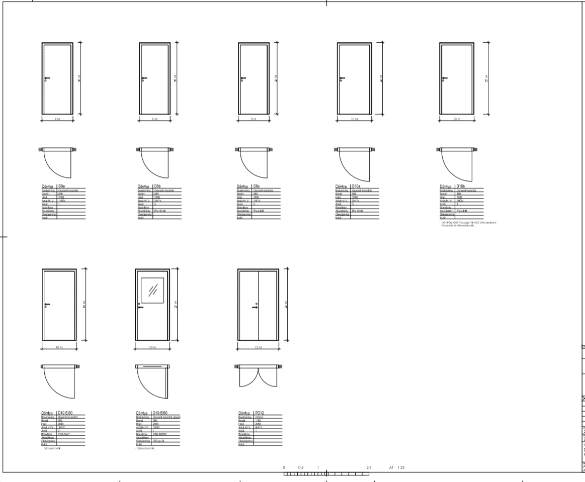

I put a photo of the plan drawing my boss showed to me. (Maybe have been done in Archicad, I dont know).

Your boss said "said to me that this is the standard".... <<< There is no such thing.
As you may have found out, you can not rotate a legend component.  I believe all of the stock Revit doors will show the swing up.  I think you should explain to your boss that you can alter this by editing every door family but that would affect every door in your current projects.  Not a worthwhile expense and possible problems.
BTW - In our office, the swing was always up in the legend plan.  When we had drafted40+years ago, it was up then as well.

They sent him this file from another architect office and he want the same. I will try to explain to him that you say.
