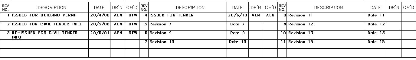

I am trying to create a Revit revision schedule that automatically splits, fitting into 3 schedules w/ 5 rows each ... like this image. I found a YouTube video (https://www.youtube.com/results?search_query=revit+split+revision+schedule) that partially works but it fails if a sheet skips a revision.
Any creative solutions will be appreciated.
