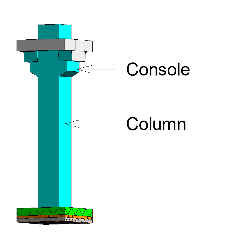

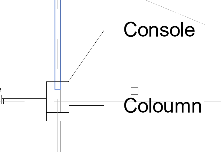

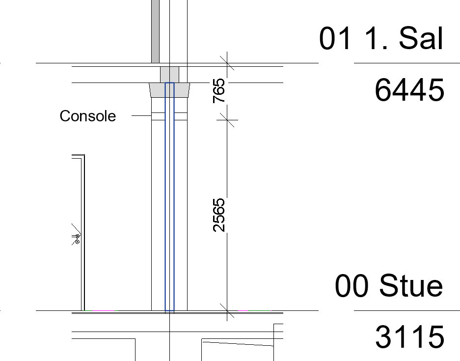

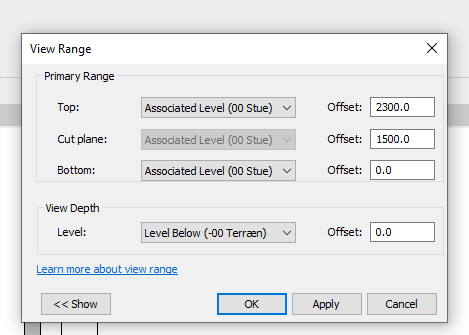

I work at an architect in Denmark and my engineer’s model is linked into my architectural project. The columns in my engineer’s model has a console, which I do not want to show in my project. But If a try to change the view range, the console still shows.
What to do?
I have attached a few images of my problem:
1: 3D view of coloumn with console
2: Plan view
3: Section view
4: View Range

Your problem is not view range, it is the column family.
Whatcategory was this family created in and is it set up to be cuttable?  Read this:
http://help.autodesk.com/view/RVT/2017/ENU/?guid=GUID-3253EFCA-F38F-4086-9A4D-C873D8D04867

I fixed the issue in the Structural Column family by unchecking the "Show family pre-cut in family views" parameter.
