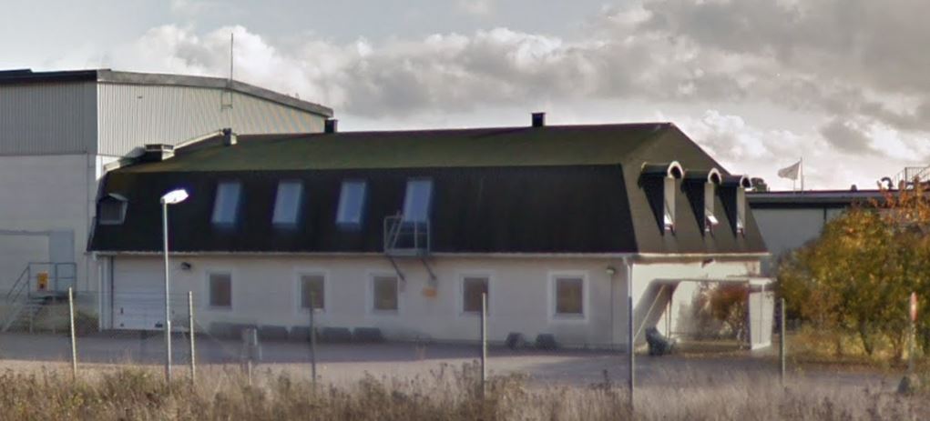

I'm really struggling with this one and wonder if anybody has any tips on how to go about creating this roof?
If I make profile, I can't make the slanted gable. If I make with mass, I can't get the windows to work.
Any tips appreciated!

Make two roofs by footprint on top of each other. Lower roof with cuffoff level. Or if you’re using 2021, you can use slanted walls for the lower roof.
