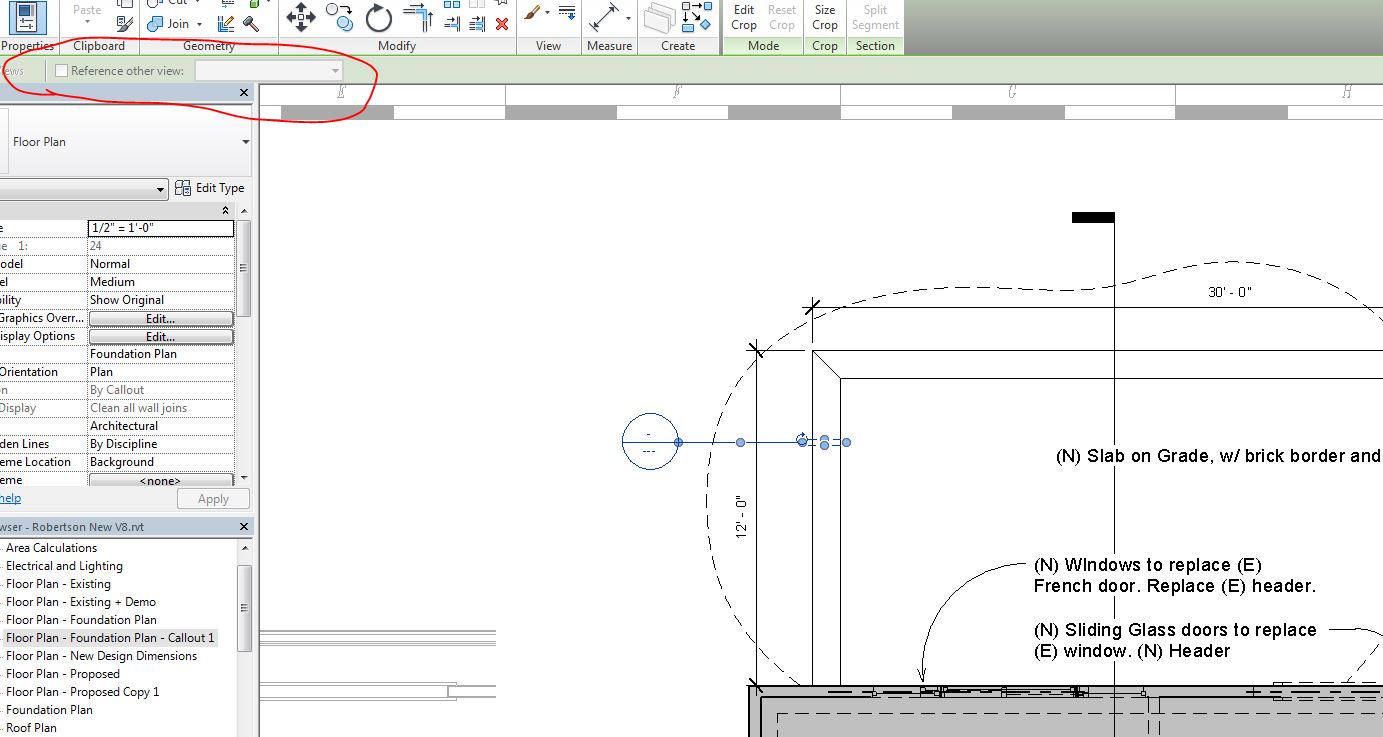

So I want this callout tag to my slab to reference my slab detail drafted view, but the "reference other view" option is greyed out. I can't think of what im doing wong.

1. Activate callout tool
2. Pick 'reference other view'
3. Place your callout.
It will not work after the callout/section is already placed.

This is the correct method. But I recently found out one more thing: View - View Reference . Sometimes the second method also helps Smile
