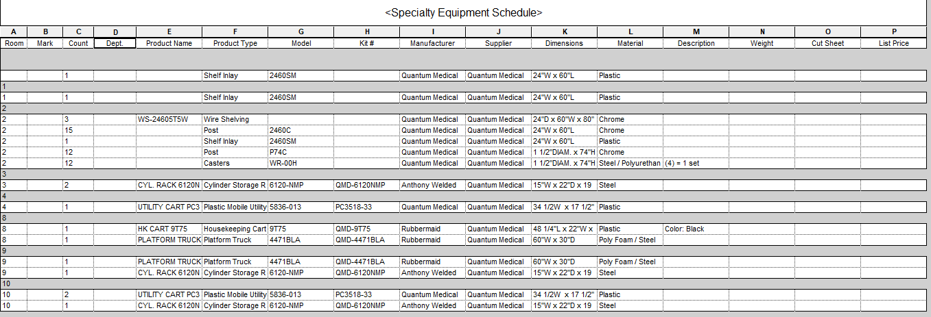

Hi all,
I have multiple wire shelving units in a project that are each made up of nested component parts (posts, casters, shelves, etc.)  When I schedule these families, the component part families show up but they are all grouped together.  Is there away to keep the nested famileies attached to their respective units?
Room 2 in the attached schedule shows my issue.  I have 3 identical shelving units but need the nested components below them to be assigned for each individual unit rather than showing all of them grouped together.
Is there any way to do this?  Any help is much appreciated!

Your schedule is sorted by rooms and therefore the items are correctly shown per room.  Maybe that will help with your thought process.

Thanks for the reply.
I need it to be sorted by Room first. Then I need the Host family and then the nested components within each Host family.
Is there no way to keep the nested components attached to their host?
