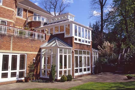

Hi all Does anyone have any ideas on the best way to approach drawing the conservatory as per the attached image. I.E Shopfront, Cutain Wall, Windows what to use!! KenP

A quick and easy way (using standard components) would be to make it out of walls and do a stacked window with transom windows and regular windows.

Use curtain walls set to automatically embed into other walls and for the roofs use sloped glazing... It should be relatively straight forward.

Thank you Mr Spot & 3DLake for your input I will give both approaches a try , when I 'm successful with one or maybe both I'll post in the gallery Thanks again KenP
