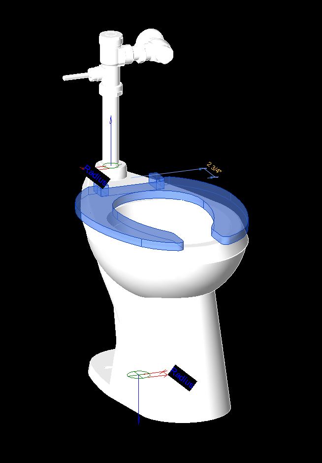

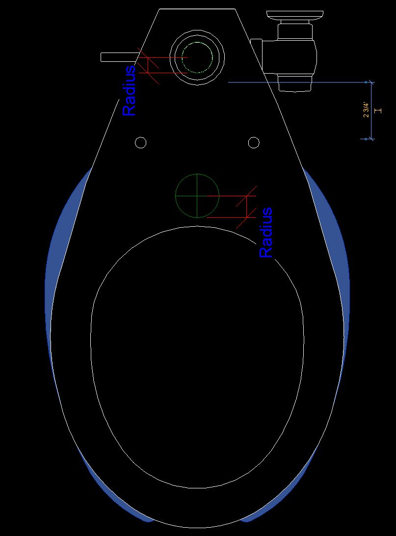

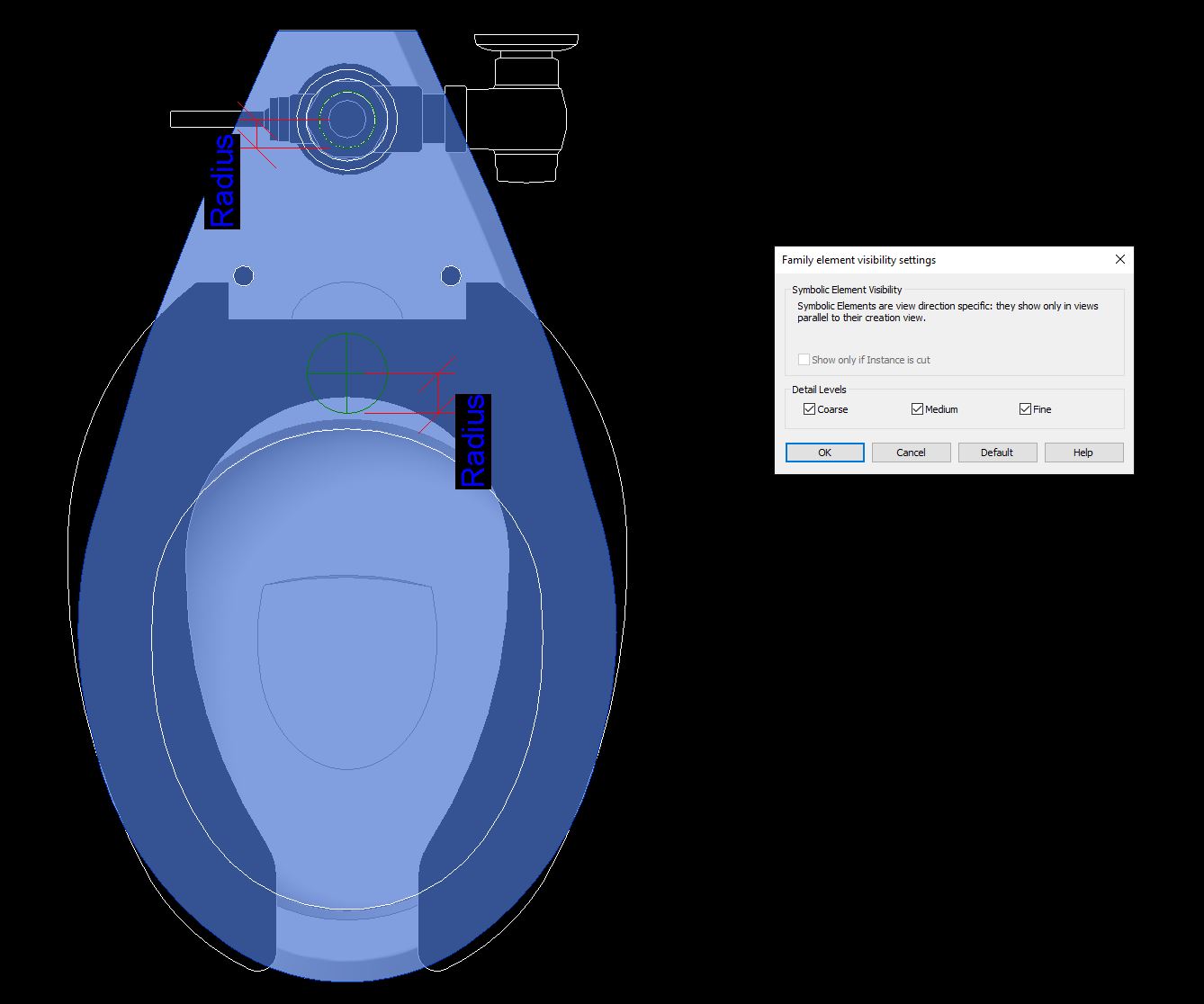

I took a toilet family and nested a flush valve and toilet seat. Everything is placed in the correct place and shows correctly in the 3D view.  However the plan view the nested elements show under the toilet.  When I checked the visibility of the toilet I get a Symbolic Element Visibility box and not sure what it is as it is different than the regular visibility box.  See attached pictures.  Can someone tell me about this as I can't find anything on the internet about it.

You typically never want to show 3D toilets in a plan view so symbollic linework is shown instead.  The flushvalve mabe a seperate symbollic family in your toilet family.  The toilet family needs to be edited to move the flust valve family above the toilet.
