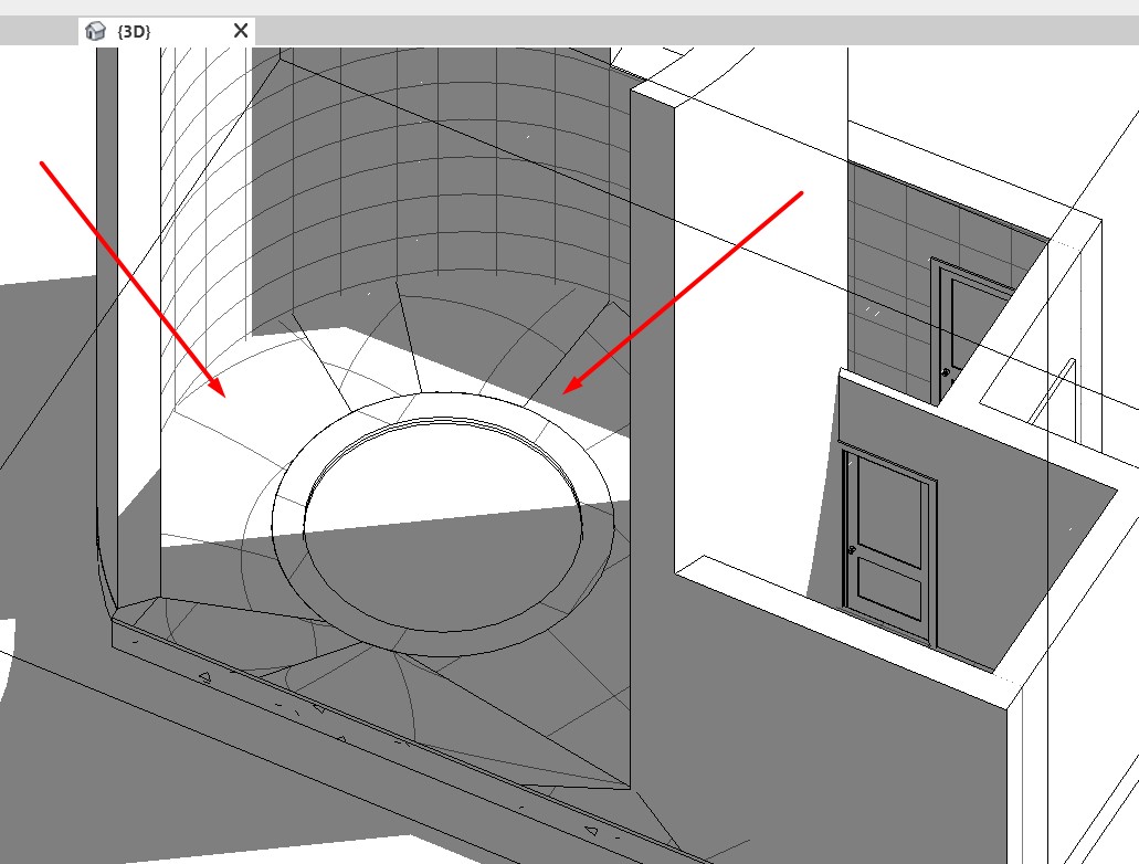

Could anybody help me with this please? I have slopped floor and a client wants the hatches of texutre to be shown on 3D view. But the hatch is disordered. But I need it to be in one direction. How can I fix it?
Tue, Feb 4, 2020 at 6:35:03 AM | R2019: Can I adjust hatch along the element?
Sorry - that floor is not a uniform slope - a single, directional hatch like brick will not work.

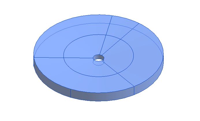

You can do it. Make a revolve  in place component and assign the material with the hatch
