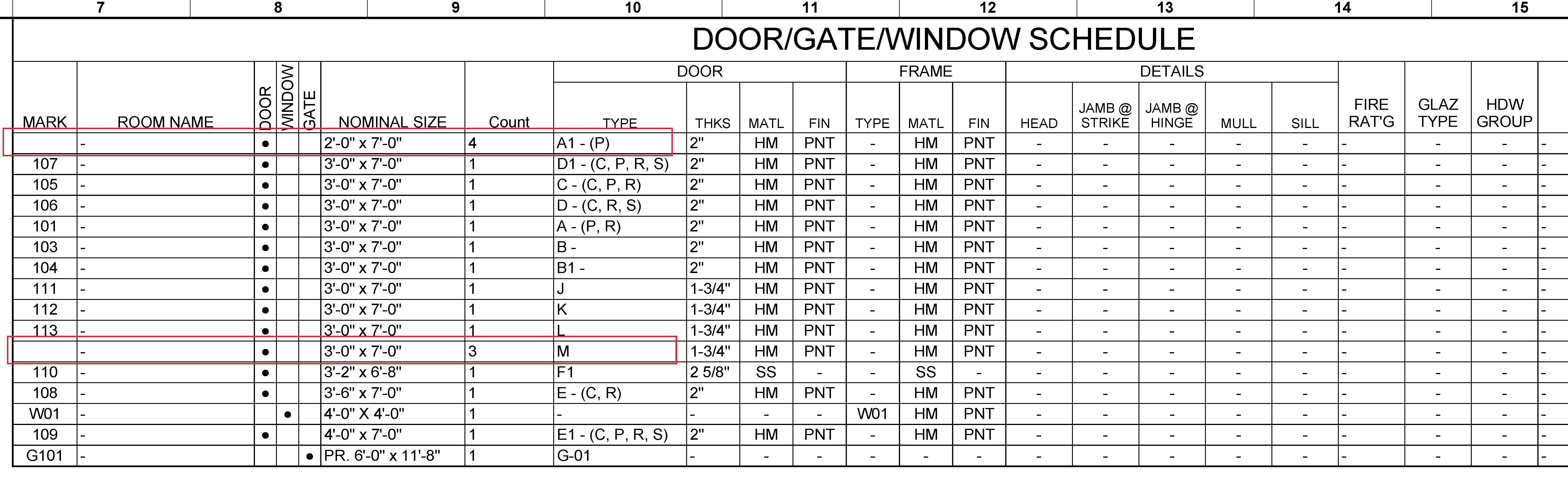

i have a window tag that is a type parameter and i would like to include another parameter that shows the total count of that family type in the project. i am not sure what the category parameter i should create to add to this tag so that i will see the the window type designation letter and the count of that window type in the model.

Wed, Jan 15, 2020 at 3:37:24 PM | parameter for family type count (2019)
CDWdavid
Joined: Mon, Aug 4, 2008
153 Posts
5 Stars: 5 Votes
Please see the attached pictures. Don’t know if that’s what you are looking for.
On attached schedule, for Door Type A1, and M, you will have the counts. However the Door Mark would not be shown for the obvious reason.

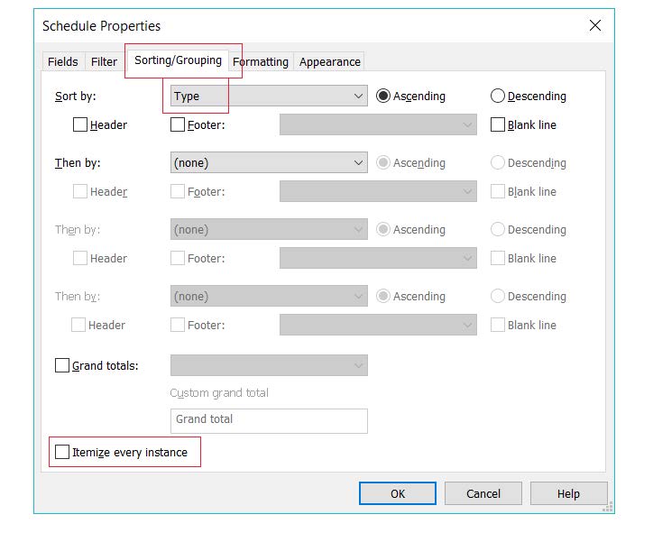

In Schedule Properties, under Sorting/Grouping, select sort by “Type”, and un-check “Itemize every instance”.
Add the “Count” field.in your window schedule.
You can try to create your window family shared parameters and play with it. Hope you can get what you want.
