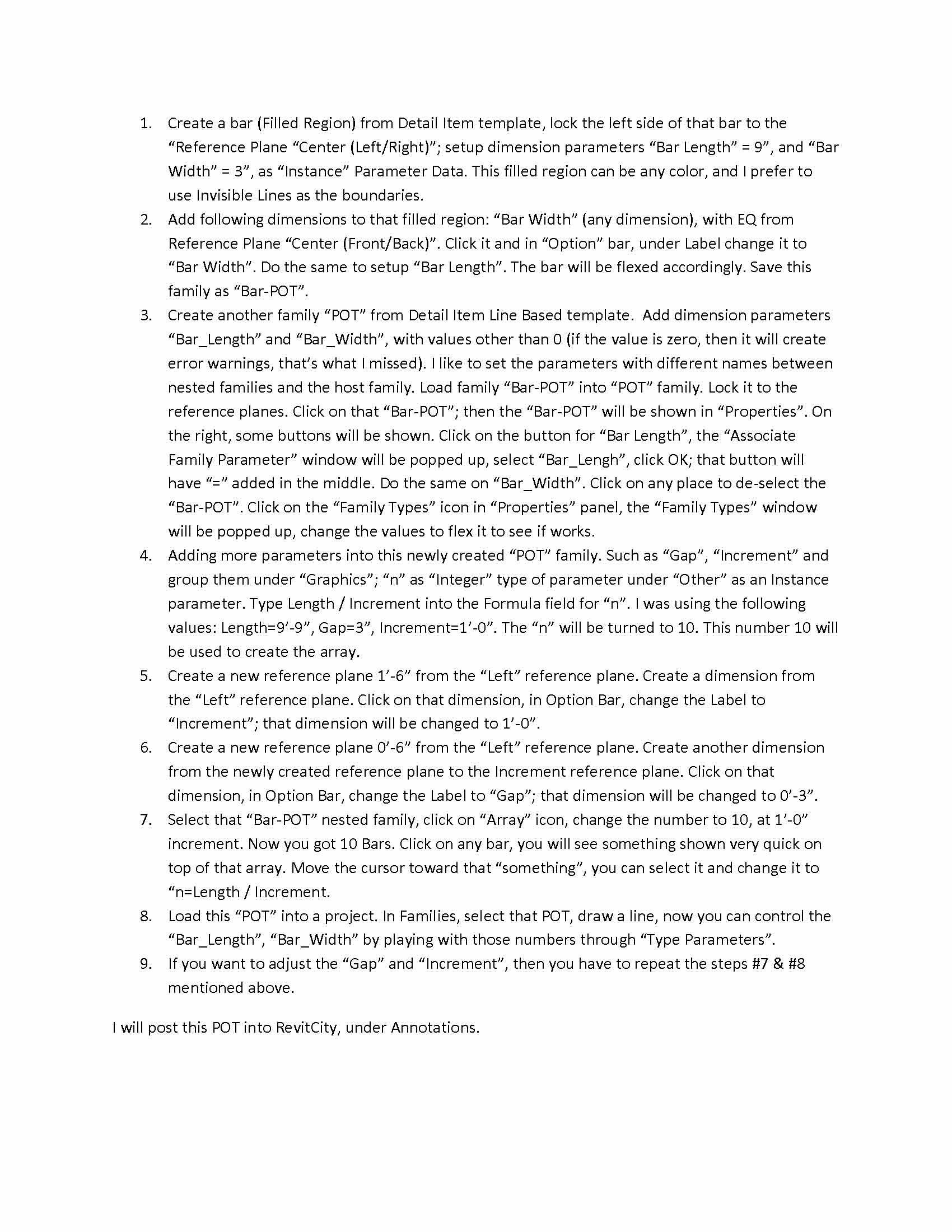

If you are just try to create a line based pattern, you may try the attached step-by-step tip.
Try this link to download the family file.
https://www.revitcity.com/downloads.php?action=downloadnow&object_id=18185&object_file_type=rfa

CDWdavid
Joined: Mon, Aug 4, 2008
153 Posts
5 Stars: 5 Votes
Hi Penandink,
Have you tried to download that POT, and place on a drawing? The only different would be that you can add a thin lines on both sides, and change the color to dark green. Revit is different from the AutoCAD, the Revit thick lines are all have round corners.

Hi CDWdavid,
I did download your annotation family, re-color it and have used it, and it is a solution.
However, it would be preferable if I could find a solution via a fill pattern, as it would allow continued use of the actual cable trays, which would be more flexible.
