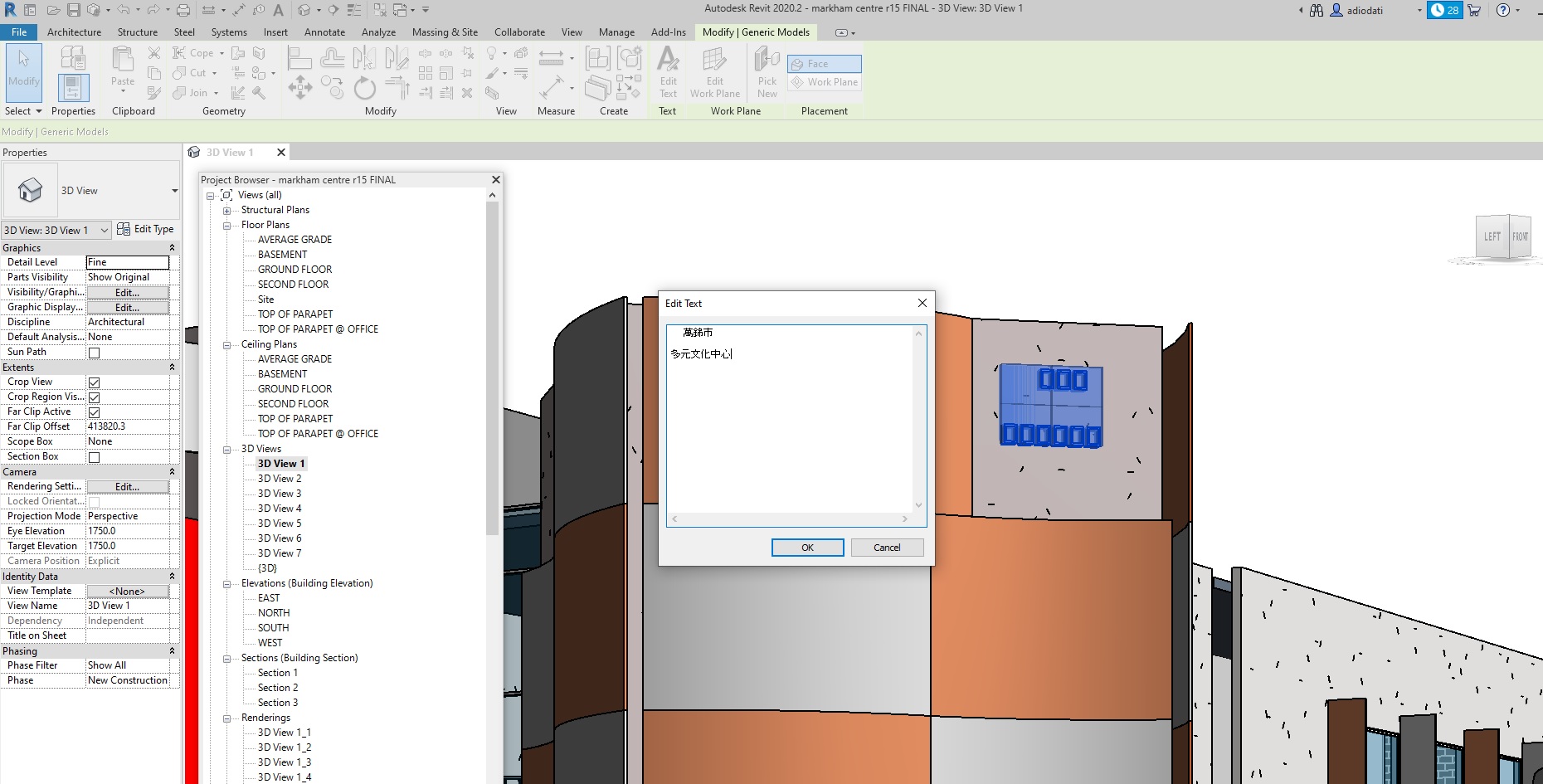

i copy & pasted chinese text in a model text on revit 2018. when i upgraded to revit 2020 and i go to edit text the chinese text is still there but when i go to a 3d view or elevation the model text appears as circles and rectangles.
any idea what is happening with this text?

Did you try any new text to see if it is affected?  If when doing that it works, then maybe the upgaded file is bad.  Otherwise, send it to Autodesk.

yes i tried all other text and  they work fine. just these chinese text/symbols that no longer reads
