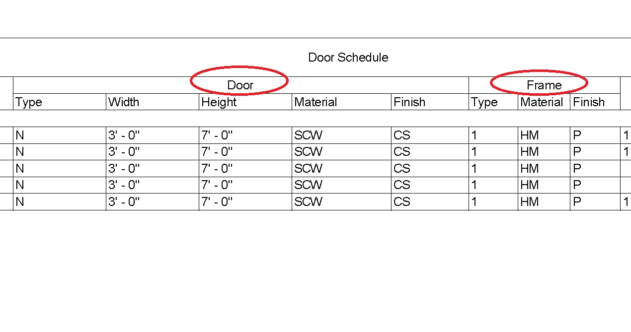

How do you get schedules to look thike these. Are these "fields" or text? Would like to know how to create a schudule like this.

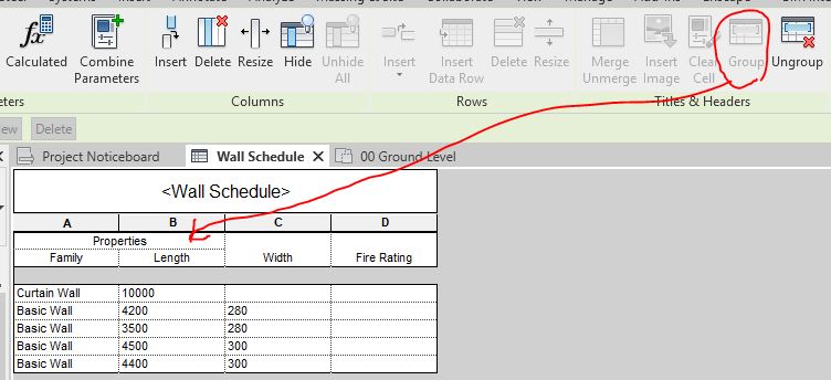

There is a group option in the schedule window - you can use that.  See attached image.
