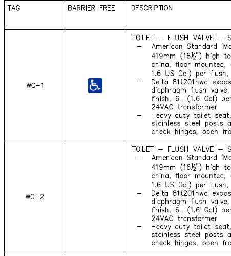

I am using Revit 2019 and trying to fancy up a plumbing schedule with a Barrier-Free image, when the fixture is intended to be barrier-free.  Ideally I'd like it to look something like this (Capture 1.JPG, below).
I can get my schedule to deliver a CHARMAP 'dot' using this line in a calculated parameter ... if(Accessible, "●", "").  Is it possible to manage the visibility of an image parameter similarly?
Additionally, I'd like to be able to manage the image size as it appears in the schedule (x/y not dpi).
Grateful for any suggestions ...

You could insert an image into the family, which you can schedule.  If the image only shows for 'Barrier Free' then don't insert images for the other families.  The column width controls the size of the image.
