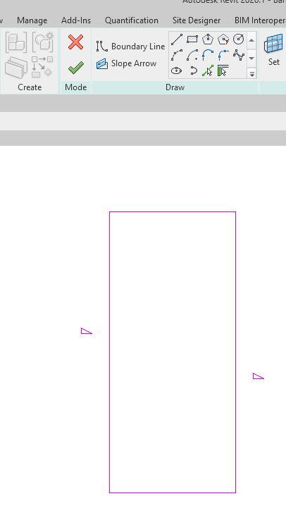

Hello Revit universe. I am working in Revit 2020, the last week or so I have been having problems when I am in sketch mode, roofs, floors, making my own component, sub-regions, etc. I can open something to edit, but when I try to save changes and exit I can't exit by clicking the green check-mark. The only way I can exit is to discard my changes. I also have a problem deleting stuff, like if I want to delete a roof that it won't let me edit. I can copy it all day and delete the copies, but not the original one. It also will not let me drag some wall ends or rotate some items, it even did this on a gridline.
Can someone please help me with this? I am current on any updates that come in on my Autodesk Desktop App. Am I missing something somewhere?

It's possible that it's on your other monitor - did you change these recently?  Try Windows button and 'P' to get the display layout.  Set it to duplicate so that both monitors show the same thing.  The reset you monitor configuration.
