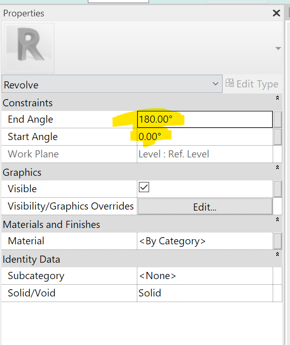

Hello,
I would like to create an awning above an entry that is about 16 feet wide and half a dome. I created a dome as a family, with a revolve but that makes a complete dome. Is it possible to split a dome in half?
Thank you in advance.
Mon, Oct 14, 2019 at 4:27:04 PM | Create a half dome
pijpiwo
pijpiwo Avatar
Joined: Fri, Sep 3, 2010
0 Posts
5 Stars: 25 Votes
With the revolve, you can specify the angle of rotation.
Mon, Nov 11, 2019 at 5:37:42 PM | Create a half dome
elizabethpetermathew
Joined: Sat, Jul 14, 2012
0 Posts
Thank you.
