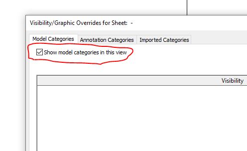

I am trying to revise out titleblock which has filled regions.  When I open the titleblock to edit, the filled regions don't appear and I can't figure out how to make them so up so I can make the changes.

Check if Model Categories are switched on.

Thank you very much! Much appricated, it was what I needed.
