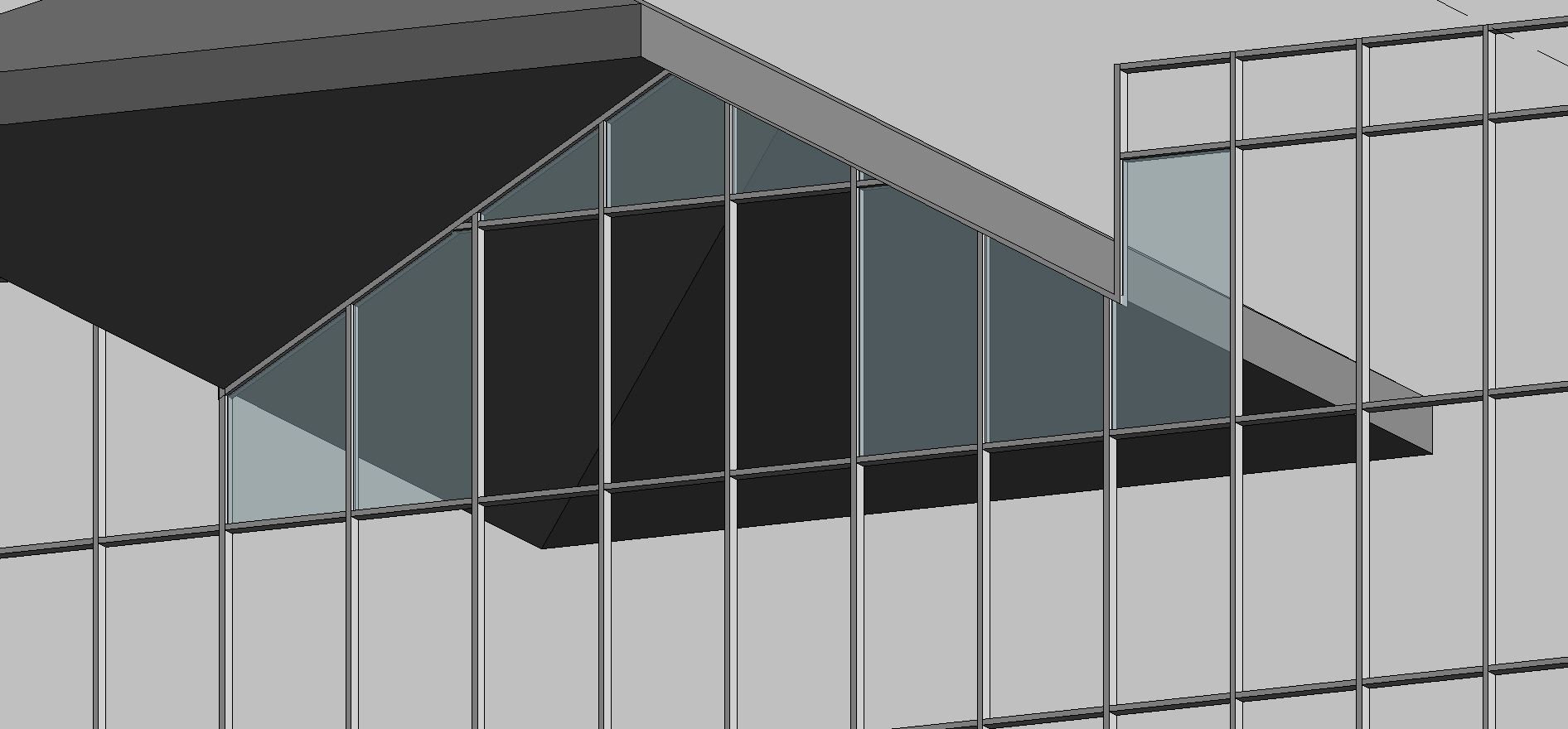

I have a various curtain wall types with empty panels and I am trying to attach them to a sloped roof.   Revit doesn't seem to like this and replaces the empty panels with glass.   The glass panels cut perfectly to th erood slope, so why not the empty pnales ?

I've seen this behavior before with custom panels. Can you upload your file so we can troubleshoot?

You try to edit the profile of the wall?
