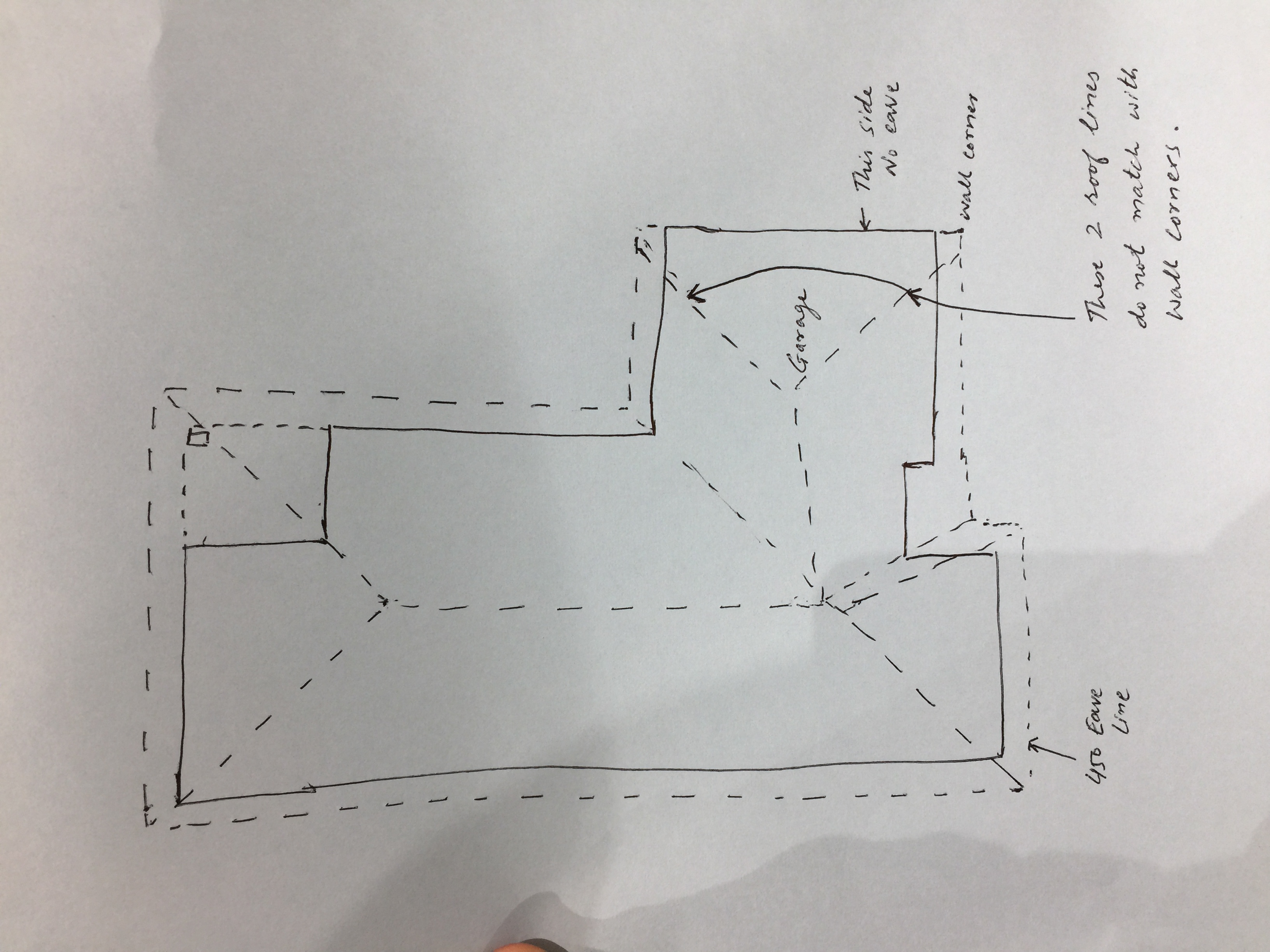

Hi I am drawing a roof on a single storey house as per the attached picture. The garage wall is 200mm from the boundary and I can not have eave on that side. All other sides have 450 eaves. When I draw the roof. The roof line does not perfectly intersects on two corners of garage wall as shown in the picture. Can you please help me and tell me how can I fix it in Revit. Regards Parm

Redraw your roof, but this time, do not use 'overhang' and 'pick walls' options.
