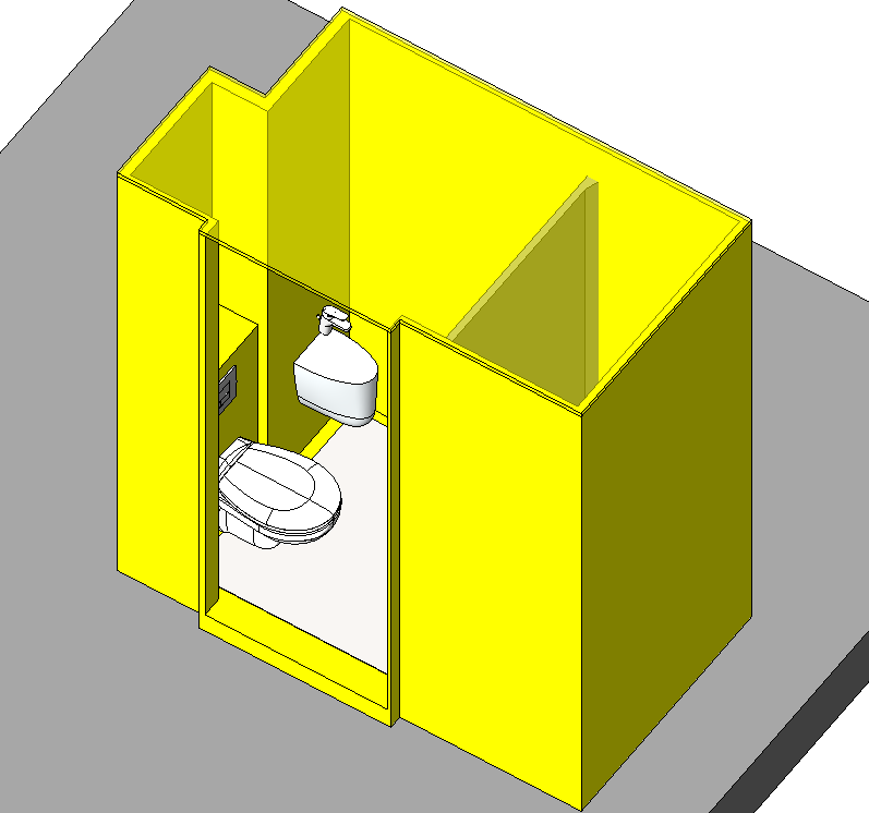

I am trying to create modular bathroom pods using an extrusion with voids to create the pod walls.
The problem is trying to attach wall based sanitary ware to pod walls as I cannot seam to snap to them.
Any thoughts welcome.

Are you trying to do this as a family?  That would be a big mistake.  Instead, use walls and create a group.  Groups can be inserted in any project just like families can.
