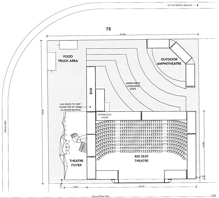

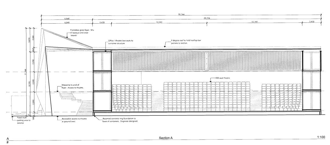

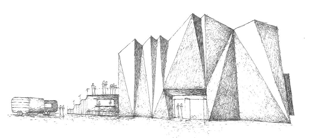

Hi there Reviteers,I work as a concept draftee for a building firm and we have been asked to draw a proposed theatre in the city i live in. I have attached some sketches from the client (As attached) and I am unsure on how to draw the proposed architectural facade. (These type of drawings dont come around very often for the buildings we construct).Any tips or tricks on the best method to draft this type of facade up will be highly appreciated!Thanks heaps people.Kind regards,Reed

Create the facades in the massing environment and then bring it into your model.  From there you can apply surface materials, such as walls.
