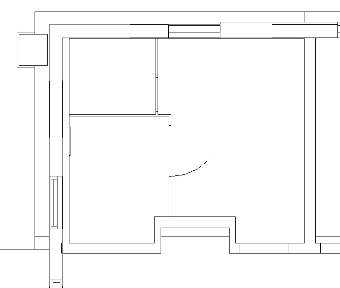

Why do I get partical swings on some doors, not others. Same door types and...everything turned off under "door" in the view templete.

That door looks like it is shown at 45 degrees - not really a partial swing.
I set my RCP so that the cut is above the doors, not cutting through them.  The door in question is being cut whereas the one above it is not.
