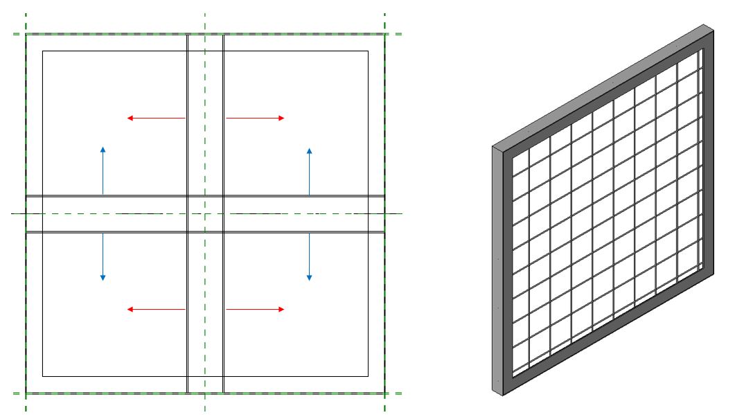

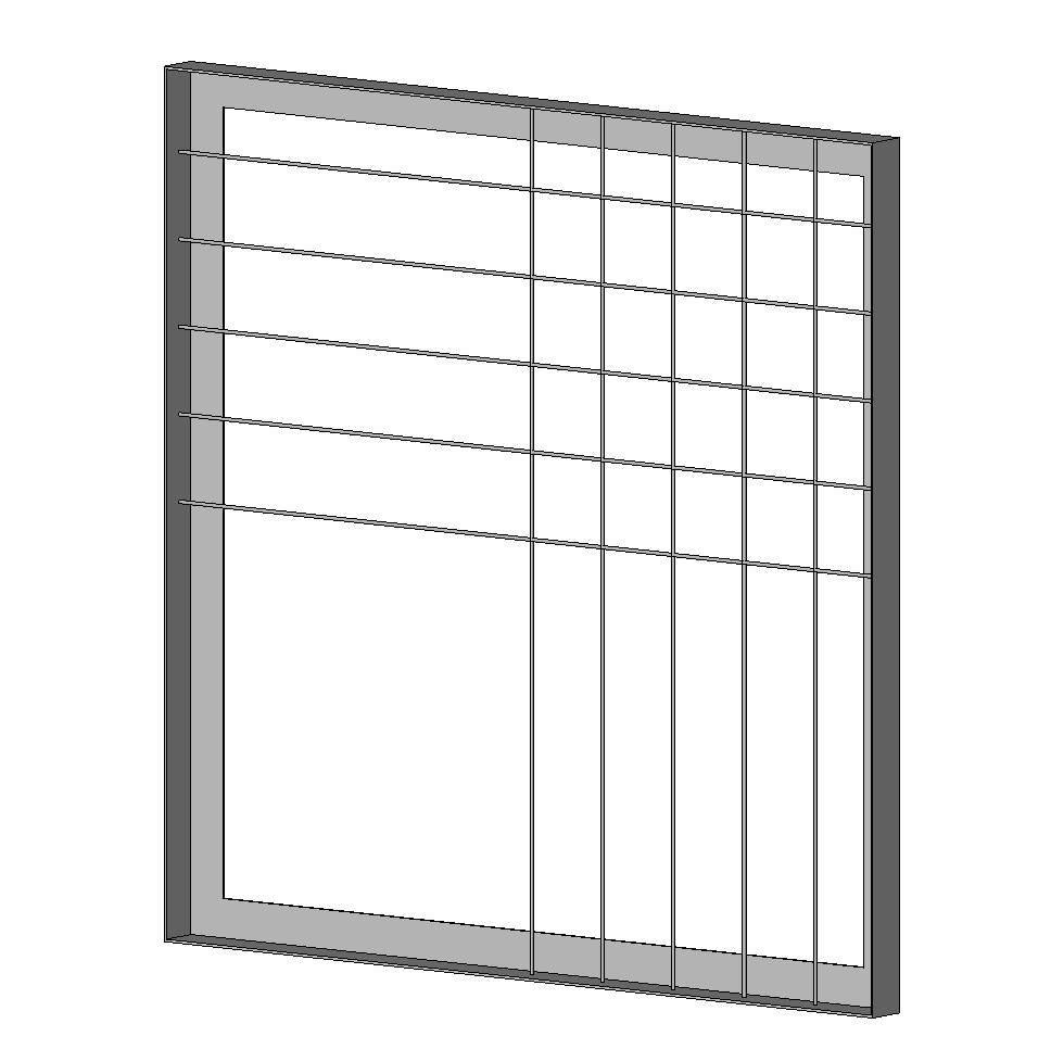

I'm trying to add an array that is constrained within the family's extrusion, but cannot work it out as im new to this level of family creation.
I need the array of extrusions to be offset 100mm of centre and not exceed my width or height parameters. In addition, the array has to be mirroed so that it is equal in the extrusion. Do i need some more parameters to define this? When i change my main extrusion the array doesn't contrain to the reference planes and I cannot figure out why.
Any help much appreicated!

hi Luke,
I believe this has been covered in other threads as WWHub has mentioned.

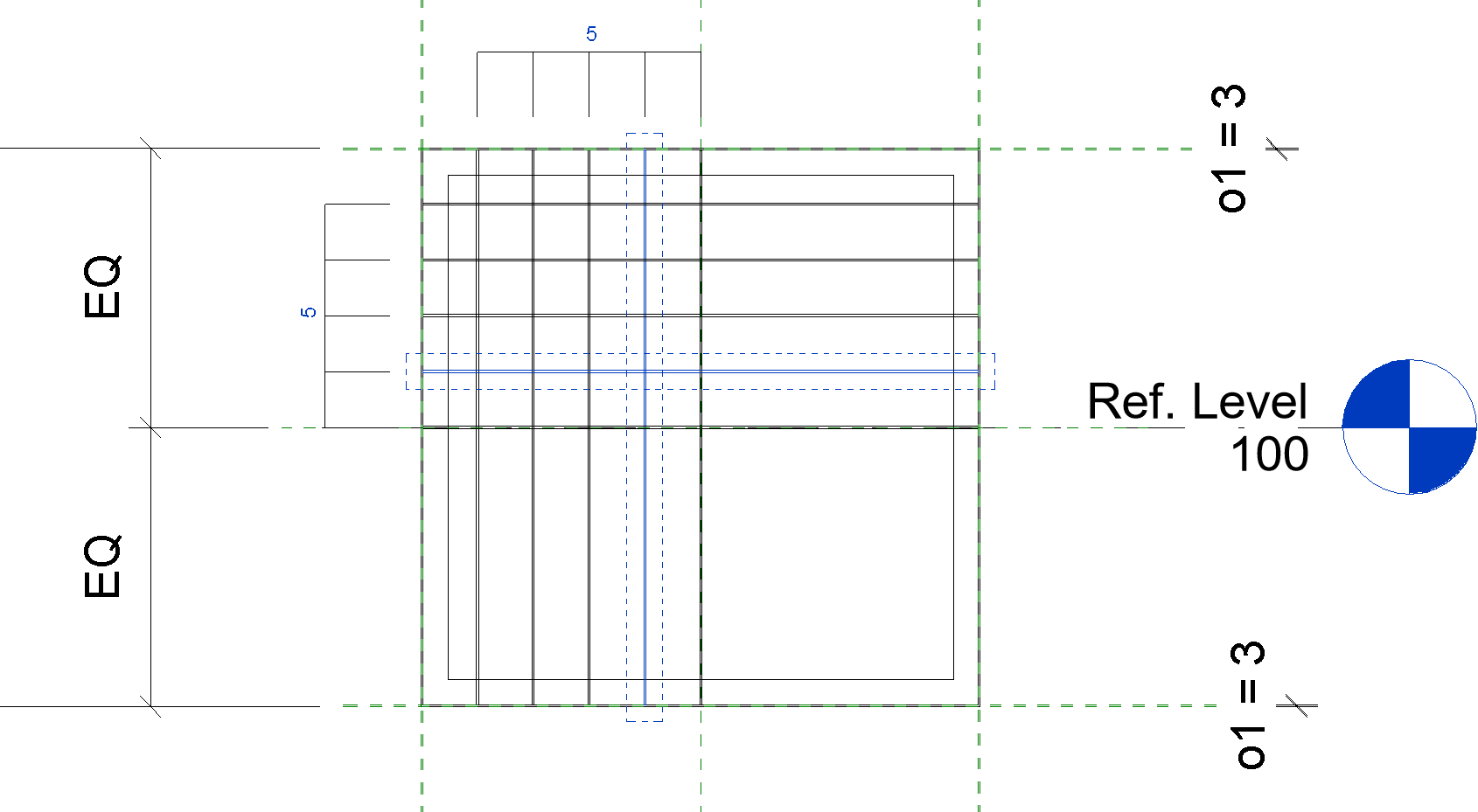

You are going to need some parameters to achieve what you are after. Basic logic you will need is IF parameters. As many people have said, you need to start with the bones of a family before you add the flesh (aka ref lines/parameters before solids).
To figure this out you need to understand the contraints you require... such as, is the spacing fixed (so always at 100mm spacing) or cant it be say 80mm to get that extra bar (as the spacing cannot exceeding 100mm?). Once you have that figured out, you can work out the formula to achieve what you need. So in essence, your formula needs to be applied to the array number and calculate how many bars you need to complete the array. So for example if Height was 1000mm...
Array = Height / 100 will return "10". However as you need to have less than the actually Height parameter's value to use, you need to adapt it accordingly, so Array=(Height - 100) / 100) would return "9".
However depending on contraints to Height you need to also consider how to achieve a whole number, so I'd recommend a rounddown(Array).
In regards to starting logic, I would recommend visually working from the centre outwards, so you will be working with 4 half arrays (See image). As I think that would look nicer, but then, thats just my opinion. If you take this route just remember to halve the Width and Height parameter Values in your formulas.
Finally, in regards to your array not sticking to your reference planes... pass. However you can resolve this by creating the bar element and its array in a seperate family and then link the child's parameters to the host/parent family's parameters. With the new family you can lock it at the base and then set it's height parameter to "Height - (o1 * 2)"
