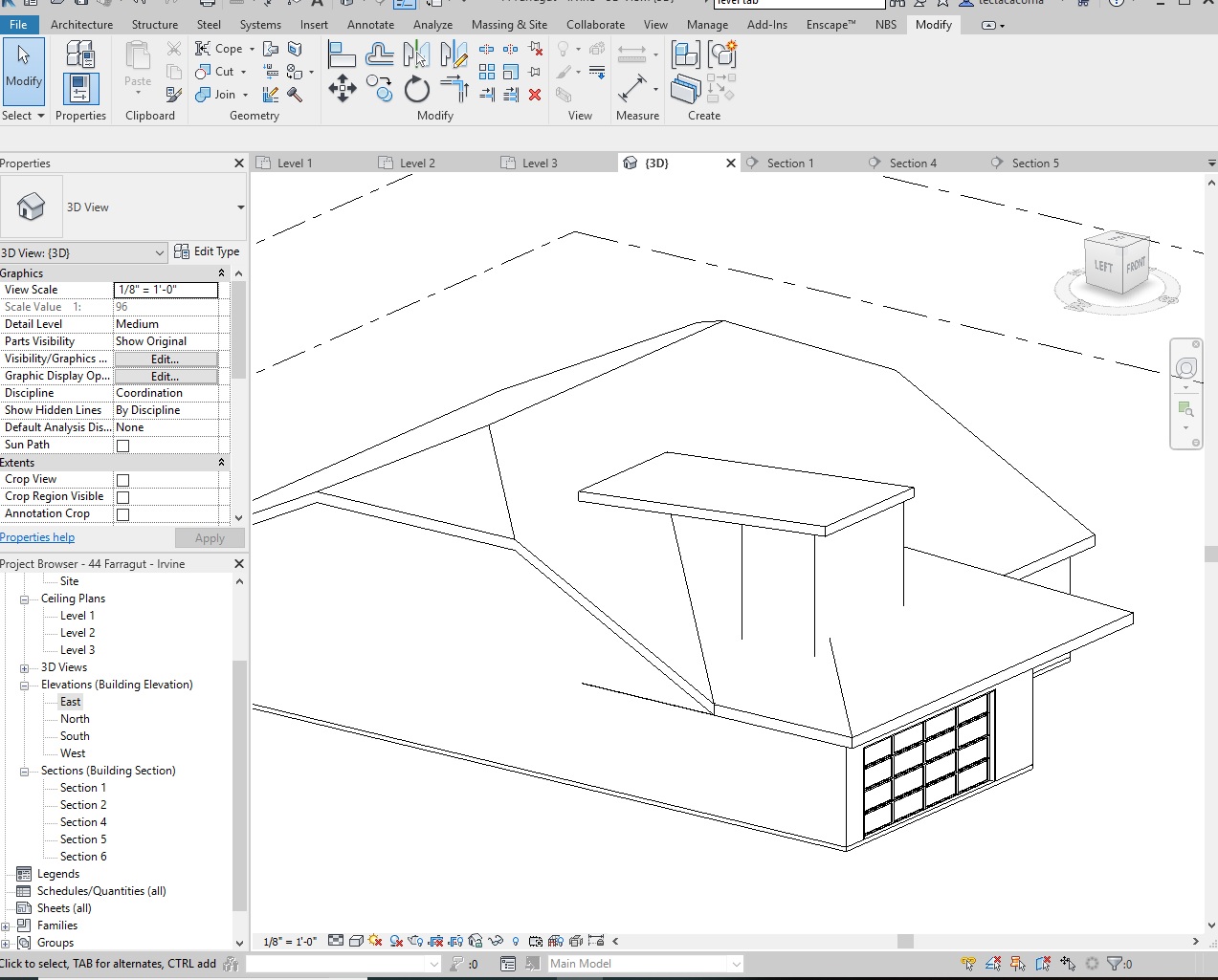

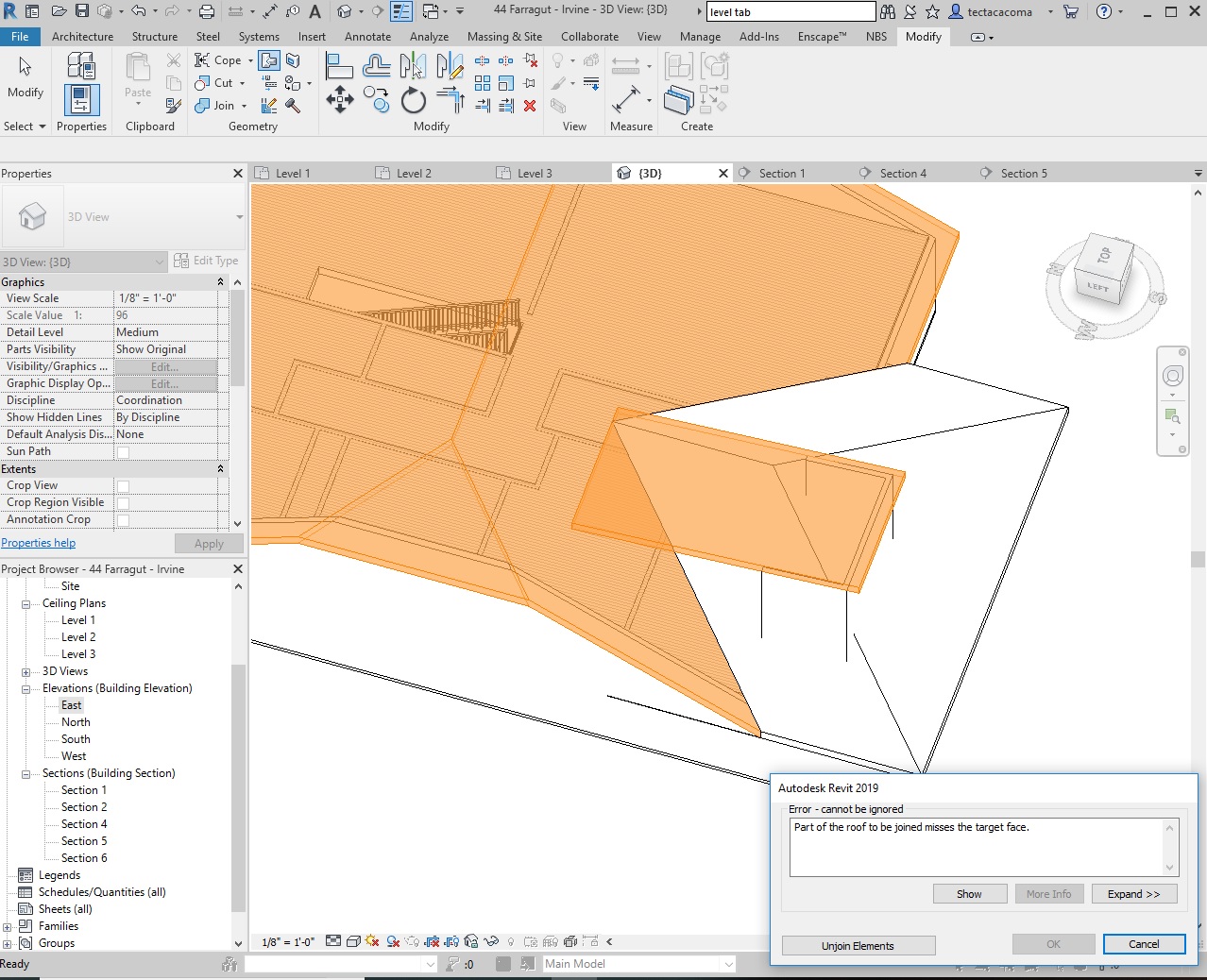

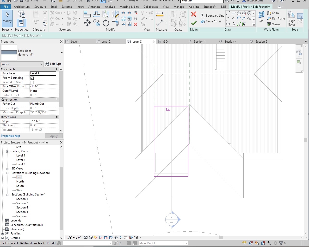

Hi guys, I'm using Revit 2019. My skill level is intermediate. I'm having problems connecting a dormer flat roof over an existing garage roof to the main house roof. See attached pictures and file. If someone could help me out would be greatly appreciated.
Thx

I added some pictures

Cut a vertical section through these roofs perpindicular to where they will be joined.
Also you said existing?  Are you using phases?

Yes, I did use phases.
I figured it out later on...Instead of using the "define slope" icon I used the "slope arrow" and then it magically worked.
