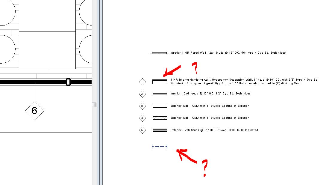

Making a wall legend. Revit 2015. im making a retail space in existing space. so there are new walls and eixsting walls and demo walls
I have a couple questions
1. How do you show different phase walls, ie. Existing walls are not shaded, new walls are (required graphic for cities) there is no option to set the wall as new construction or existing. it just shows the new...
2. One of my walls is a curtain wall. but in the legen component its invisible, no glazing or mullion to show, just the dotted line when selected. so do I just illustrate one?
see picture.

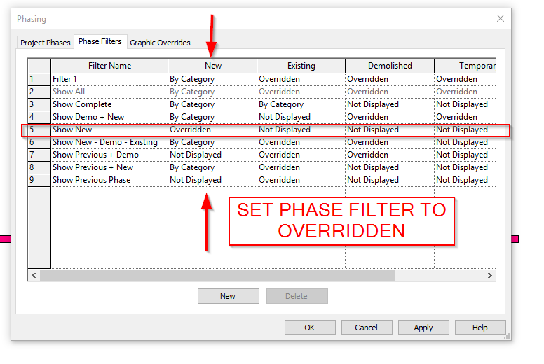

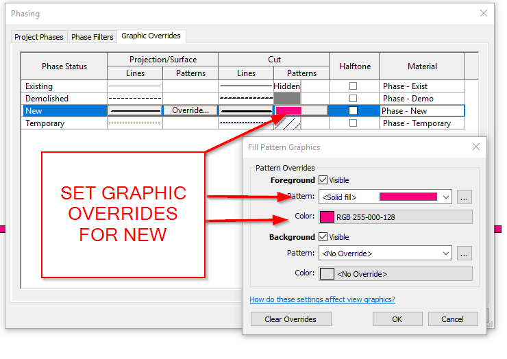

Set Grphic OverRides for phase new to show color you want in cut.
Set Phase Filter you are using to show New as "Overridden"
HTH
