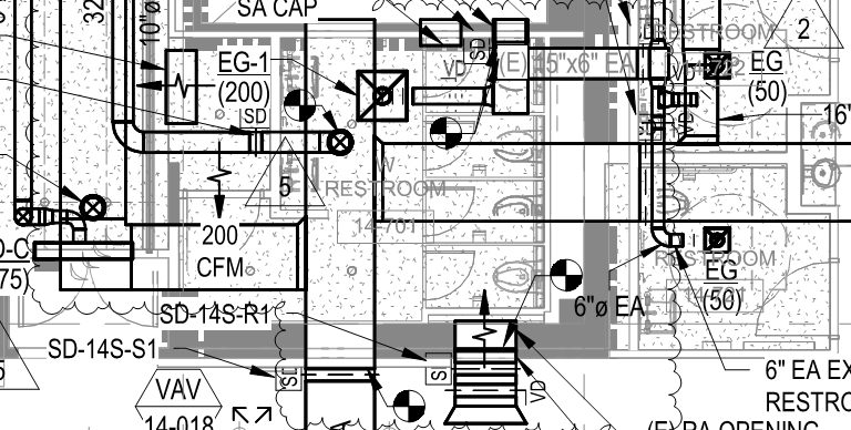

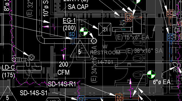

I have a visibility issue that is affecting only a pair of views in my project.
I have a setting for ductwork I set as "Existing" to appear as halftone. It looks good in every view. However, when I create a .pdf,  two of the levels print 100% black lines for the exiting ductwork. I've tried overriding the viz setting to be halftone, but it continues to print 100% black lines. It's only happening on those two levels. All levels appear to have the same settings, including Filters and View Range.
Any thoughts on why two levels wouldn't recognize the haltone setting for ductwork that is set to Existing?
I'm attaching an image from Revit and from my .pdf
Thank you for your time. I look forward to your response.

maybe you have phase filter in "show complete", must be in "show all" (in properties of the view)
