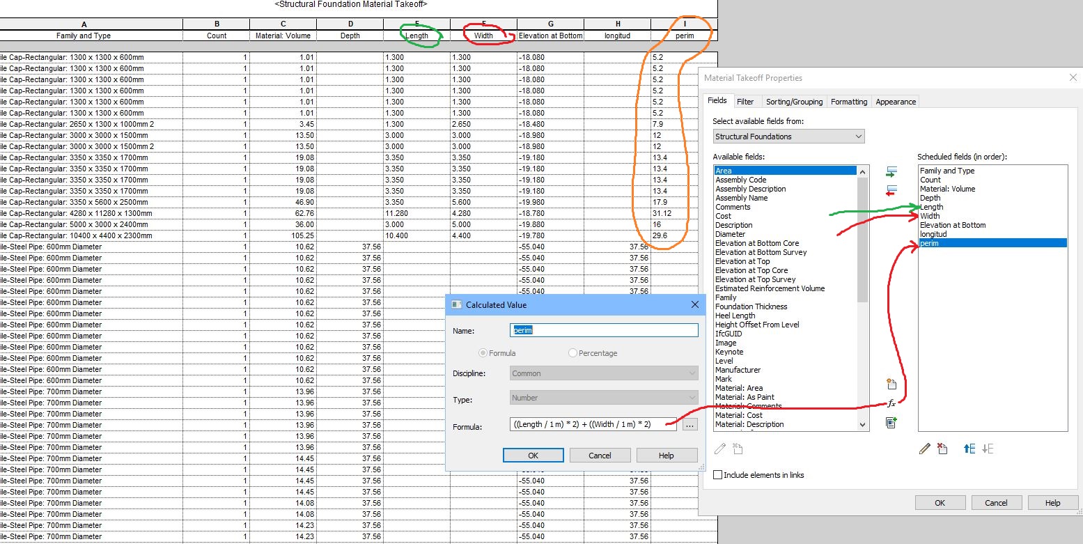

I am trying to calculate the girth (perimeter) of pile caps, regular and irregular shapes, within the Structuural Foundation Schedule in order to calculate working space, formwork and Claymasher heave board with no luck.
Any advise greatly appreciated.

Make a formula in the schedule and use the "/1" trick to avoid that stupid problem of inconsistent units in revit
