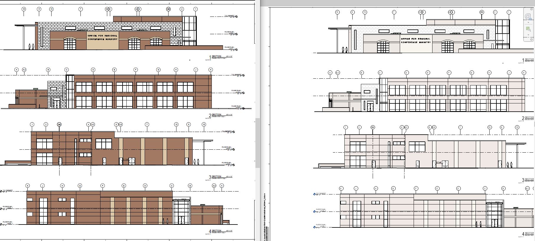

See the attached image.  I'm in Revit 2019.
I have a sheet with elevations, all of which are set to Hidden line.  There are no filters, no VG overrides, and no overrides per element.
When I pdf the sheet, most of the walls & other components print as consistent colors, but not consistently.  If I set the view to consistent, the walls showing up as black and white have color, and print that way, too.
I've duplicated the views and replaced the views on the sheet with the new ones -- same story.
If I pdf the views individually (not on the sheet) -- same story.
I set up the print to go to our plotter and it comes out fine.
I've tried two different pdf drivers with the same results.
Is there a setting I'm missing somewhere?  Maybe in the print dialogue?

Nevermind!
It was colors applied to the surface patterns!
Jeez ...
