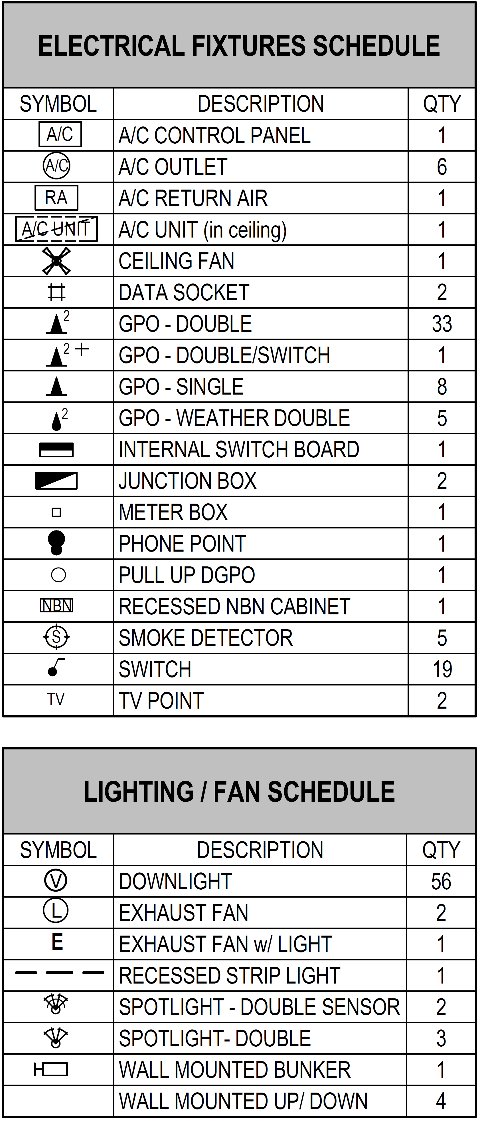

Can anyone advise how to make a symbol electrical schedule that includes the quanity?

Just make a schedule.  Use the Count parameter to show the quantity.  Set this so it doesn't 'Itemise every instasnce'.  You can also include images in schedules so you can show the legend also.
