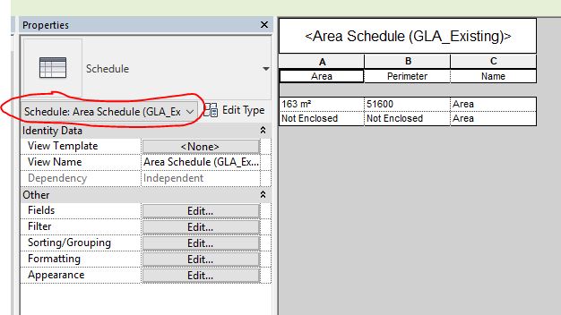

Greeetings.
I have a few different area schemes and a few different area schedules ... how can I identify which area scheme is associated with a particular area schedule?
The 2nd question: can an area schedule be associated with a different area scheme?  I suspect that the answer to this is "No" but I hope I am wrong.
It is my hope to avoid (re)creating similar schedules for each scheme, but again, I suspect I will need to do just that.
Thanks, in advance, for your input.Ian

Question 1: You will see the Area Scheme in the view properties, as shown in the image.
Question 2: You cannot change the scheme for an area schedule, as that is what it is based on when it was created.  But once you have it set up, you can create a view template from that and use it for schedules generated from a different area scheme, so that you don't have to do all the setting up again.
