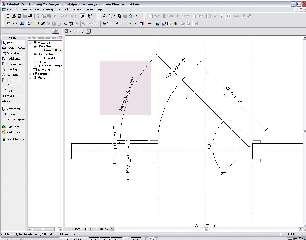

I am just wondering if it is possible to show door swing with different angles other than 90 degree open, in floor plan, like 45 or 60 degree open? If so, could someone give an overview of the process. Any directions would be greatly appreciated!

Go through the in-built tutorials. Last time i checked there were tutorials on created doors with adjustable swings. But basically all you need to do is add an angular dimension parameter (I do its as an instance parameter). HTH.

Yes you need to simply add a parameter for the swing to the plan view of the family. Attached is a family that allows one to choose the angle.

i have been having the worst time trying to accomplish this. everytime i change the angle, the rectangle that symbolizes the door in plan completely falls apart... what step am i missing? I have the rectangle constrained with the door width and the door thickness.

I have modified an existing family to have this adjustable swing. I works well and I have "flexed" it. It works for all angles except 90. (havent tried 0)
I cant understand why its misbehaving? Would anyone be kind enough to look at it to see if you know what I'm missing?

The problem is in the "ARC", here you have, take a look...

Thank you!!!
That works, I'll study what has changed. cant see it yet, but thank you!
