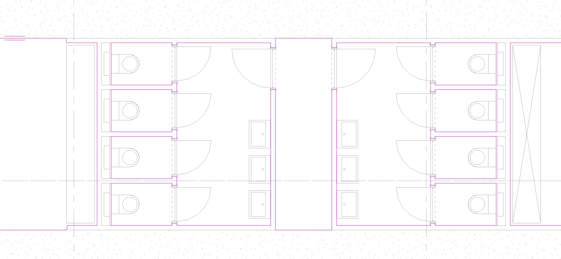

I have a question regarding wall intersections with floor layers.For our floor area schedules I would like to have an accurate amount. Therefore the walls on this floor should penetrate the finishing layer, lets say ceramic tiles in a restroom, so the area underneath the walls doesn't get counted (but all layers of the floor underneath do need to be counted).
Is it possible to have this done automatically or do I have to split the floor into two seperate floors? One with the floor finish and one with all the other needed layers like structural element, insulation etc?  Then model the floor finish around all the walls.
If i need two seperate floors and I move some walls, I need to manually adjust the ceramic tile/floor finish... That doesn't make sense to me in a Revit/BIM context...

BTW.... I suggest you do your floors without a finish and you do your floor finish as floors defined in each area.  This allows you to have carpet/tile or whatever finish in seperate areas and also allows you to set your patters up correctly in each area. VERY important for tile patterns!

Thanks for useful info! I'll get into it!So if I understand correctly, you do advise using a seperate floor wor only the floor finishes and go around every wall like in the picture attached, right?
Mon, Mar 11, 2019 at 3:49:26 PM | Wall intersections with floor layers for area schedules
Yes, you would outline each floor area that you may want a different tile pattern in.  I always had seperate areas at doors because you use a threshold there ... typically.
IMPORTANT:  You don't have to sketch this area, that is a pain for non rectilinear spaces.  If you have your walls and doors as room bounding, you can use an automatic ceiling to create a sketch of that room boundry.  Edit this sketch so you can copy it to your clipboard.  Now you can delete the ceiling if you don't want it.  In your floor plan, you can create a floor and edit in your sketch of the room outline you just created.
