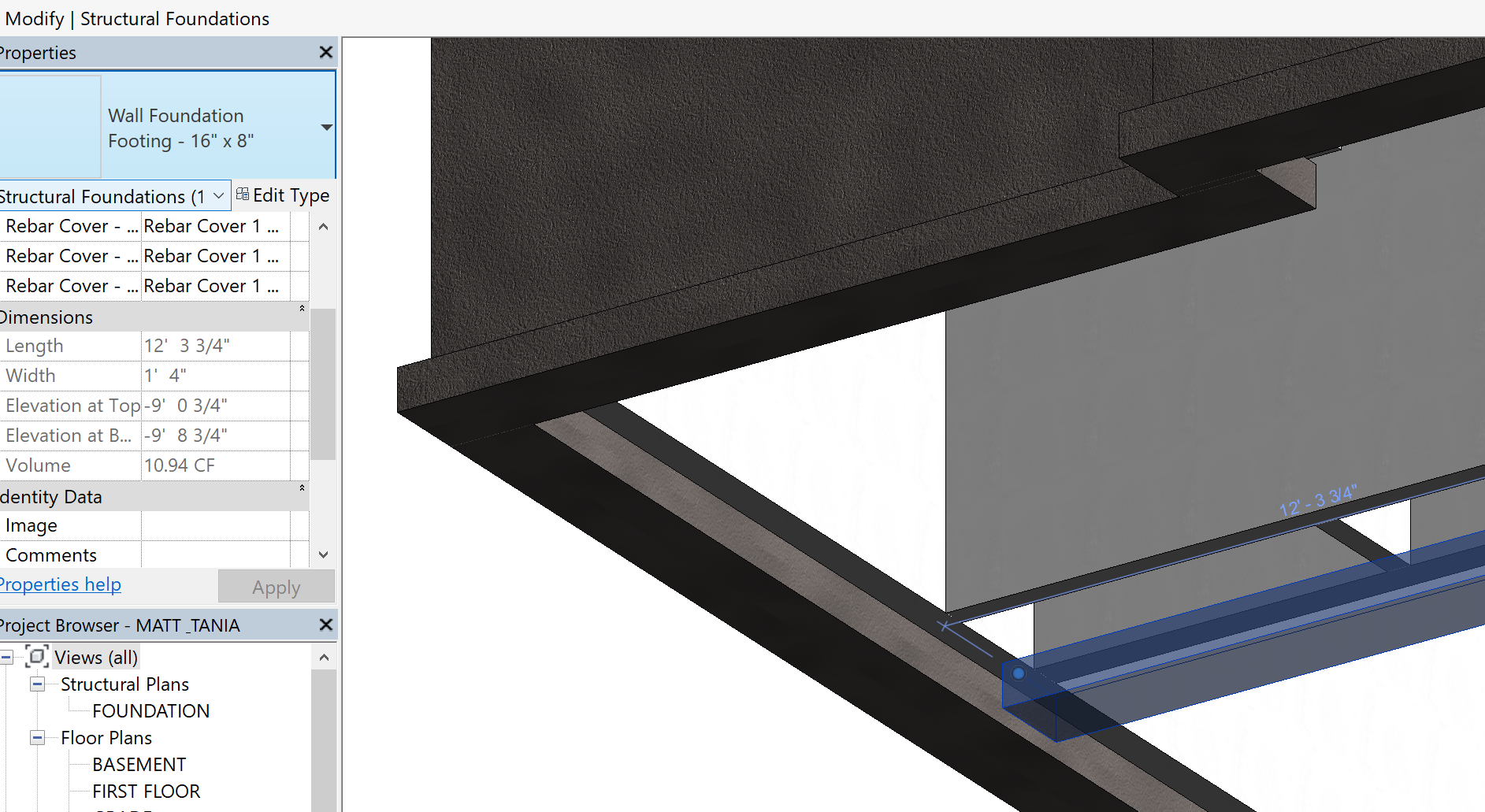

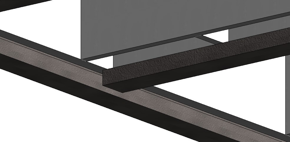

I searched a bit and couldn't find an answer to this one. Is it possible to lower the interior load bearing wall footing the thickness of the slab, for it to match with the foundation wall footing?
I could just extend the interior wall down (thickness of slab), but I would like to have my slab go through just like in real construction.

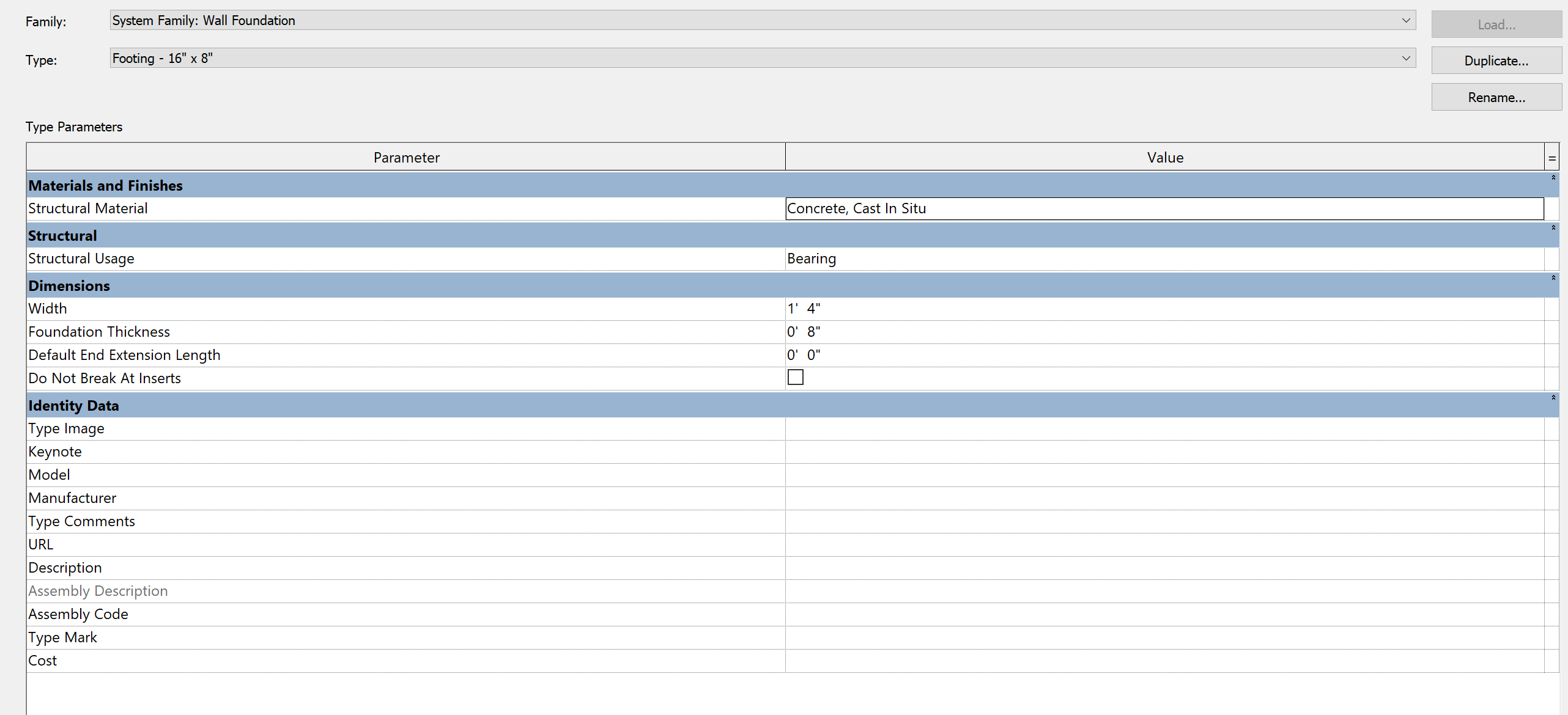

Select it and check the properties window. Is there a parameter that allows you to lower it. Or edit its type and in properties see if there is a parameter to offset it from the bottom of the wall. Just remember if there are other footings of this same type then you may need to duplicate it so this parameter change does not change the others.

When selected, the elevation is grayed out, and in edit type, there's no elevation offset value.

Even when applying new footings, it doesn't let me dictate its height location. it forces me to attach directly to a wall base.
