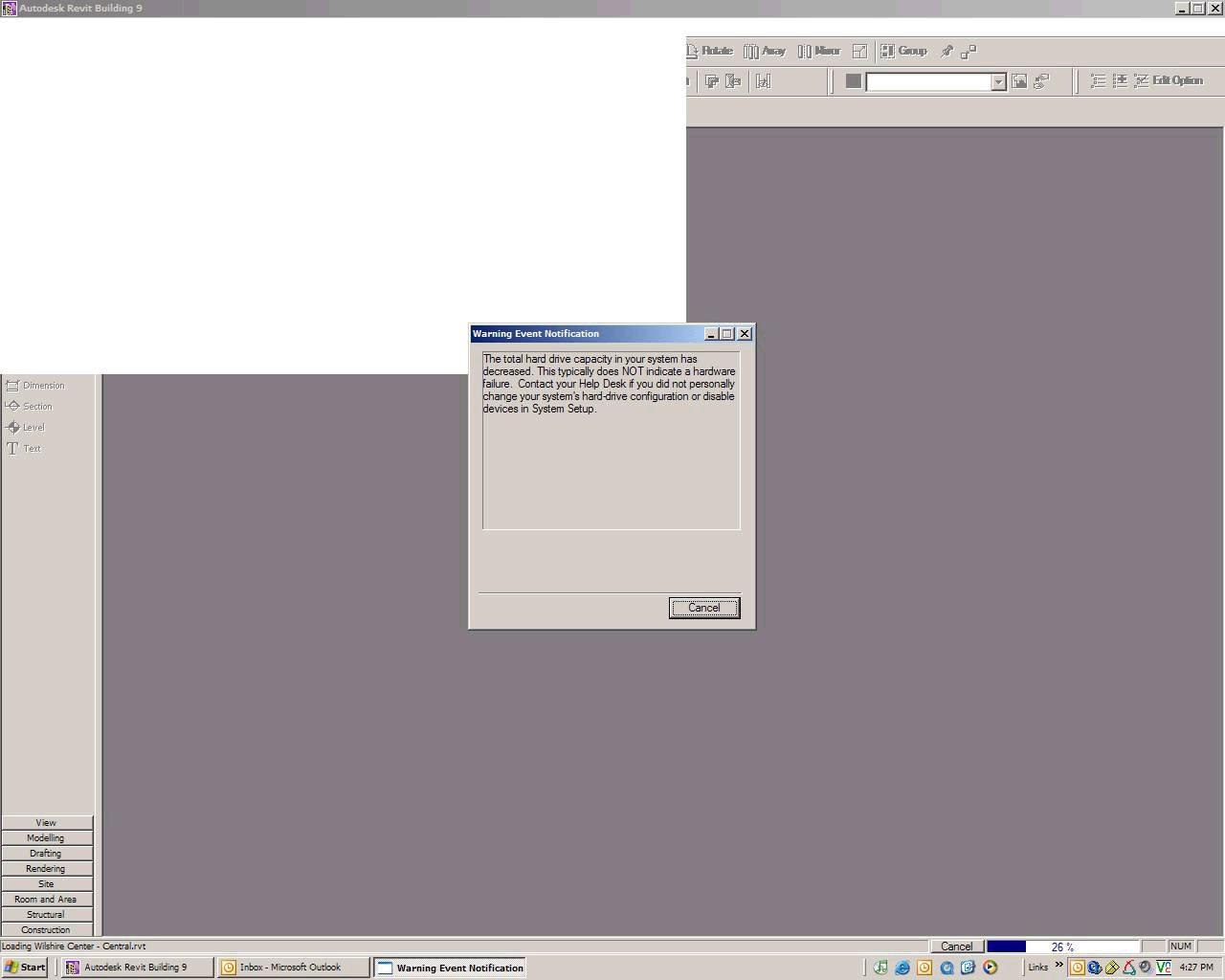

I have a user who says he gets an annoying warning when opening Revit 9 files. The message is "The total hard drive capacity in your system has decreased. This typically does not indicate a hardware failure. Contact your help desk if you did not personally change your system's hard drive configuration or disable devices in startup." I think he is getting this because the central Revit file was moved to a different server. Any ideas?

I found a resolution. The issue is not a Revit error but caused by Dell OMCI software. I uninstalled Dell OMCI software to fix the problem.
