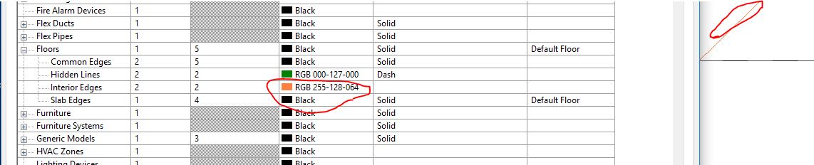

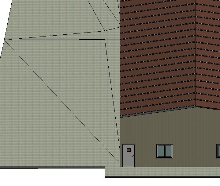

How can I eliminate the black object boundary lines or lines indicating a slope?  Please see attachment.  I created the concrete slab by using the Floor option.  I have tried everything from adjusting the visibility/graphic line colors to material settings.  I am a new user operating in verstion 2019.  Thanks in advance, this is driving me nuts!

You can set this in the object styles for floors - Interior edges.

Worked; thank you!
