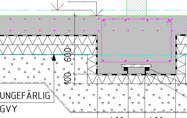

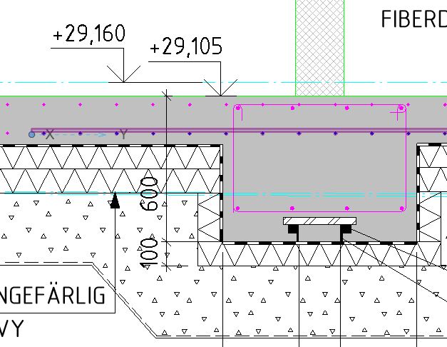

I have tried everything I know about visivility settings. But I still cant make the rebar that is parallel to the section visibile. As you can see on the screenshoot i can only see the bar that is cut. If I place the cursor on the rebar it appears. I can make the slab transparent if I want to see the parallel rebars, but with that I get a lot of another problems, there must be an other solution.
The picture where I can see the parallel rebars i have the cursor on the rebar.

How did you do the ties in the col pad?
To see the horizontal, you would have to cut through the middle of the bar (not even sure that it would show up then).... but then if the tie is a model element, it would not show because two objects never really occupy the same space.

My english is not 110%, could you explain that question? haha.. What is "tie" and what is "col pad"?
Fri, Dec 21, 2018 at 10:05:31 AM | Visibility of fabric sheets
Sorry, I should have called that a grade beam and the stirrup in that (Wraps the steel for shear).

I moved the sectiion so it cut the rebar, but that didnt help.
And yes, the tie is a model element. But of course I should see the rebars, I can see all the other rebars, except just this one..
