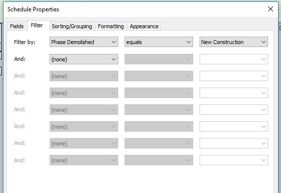

Is it possible to create a filter that you can filter walls that have been demolished?  I don't see an option like that Sad

Yes, you can do that.  For a schedule - see attached.
If you mean in the view, you can control it with the phase filters and graphic overides.
