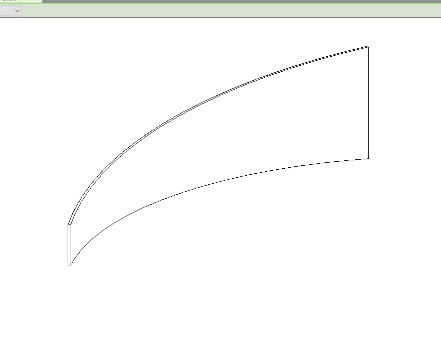

How can I add a railing on this wall. I tried a mass form which would work for a straight wall but this one slopes so I cant rotate the mass. Any ideas

I think it's doable.
See attached pictures.

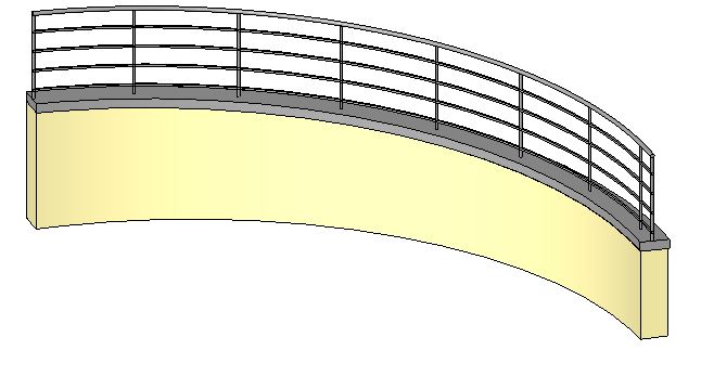

Did you try my suggestion?  Here is a curved sloped floor on top of a curved wall that is attached to the floor.  The railing hosts to the floor. The floor can be given the same finish as the wall.

John
I drew a curved wall (normal wall - not a mass).
I drew a curved floor on top with a slope arrow.
I attached the wall to the floor.
I drew a curved railing over the floor.
I hosted the railing to the floor.
Curved railing.
