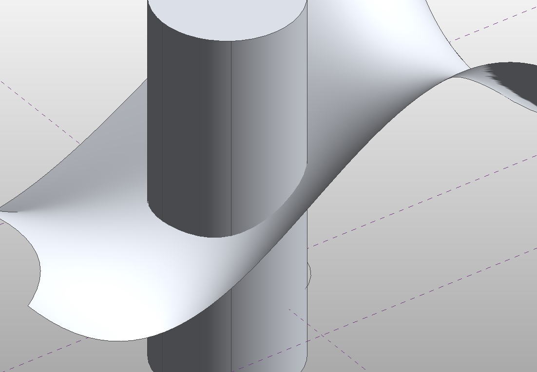

How can I put a hole thru a surface. When I remove the cylinder the surface is still there. Not sure if this can be done in conspetual mass.

This shows how to cut with a solid http://help.autodesk.com/view/RVT/2014/ENU/?guid=GUID-85920F8B-E67C-46D3-8296-000B06075843
but if you want to remove the solid, you need to use this instead. http://help.autodesk.com/view/RVT/2014/ENU/?guid=GUID-7C940A08-1F62-465F-89BF-3800E3446FC3

Cant get those methods to work on this item.

I guess revit isnt smart enough to cut a varying surface. I tried it on a square like in the examples and it works.
