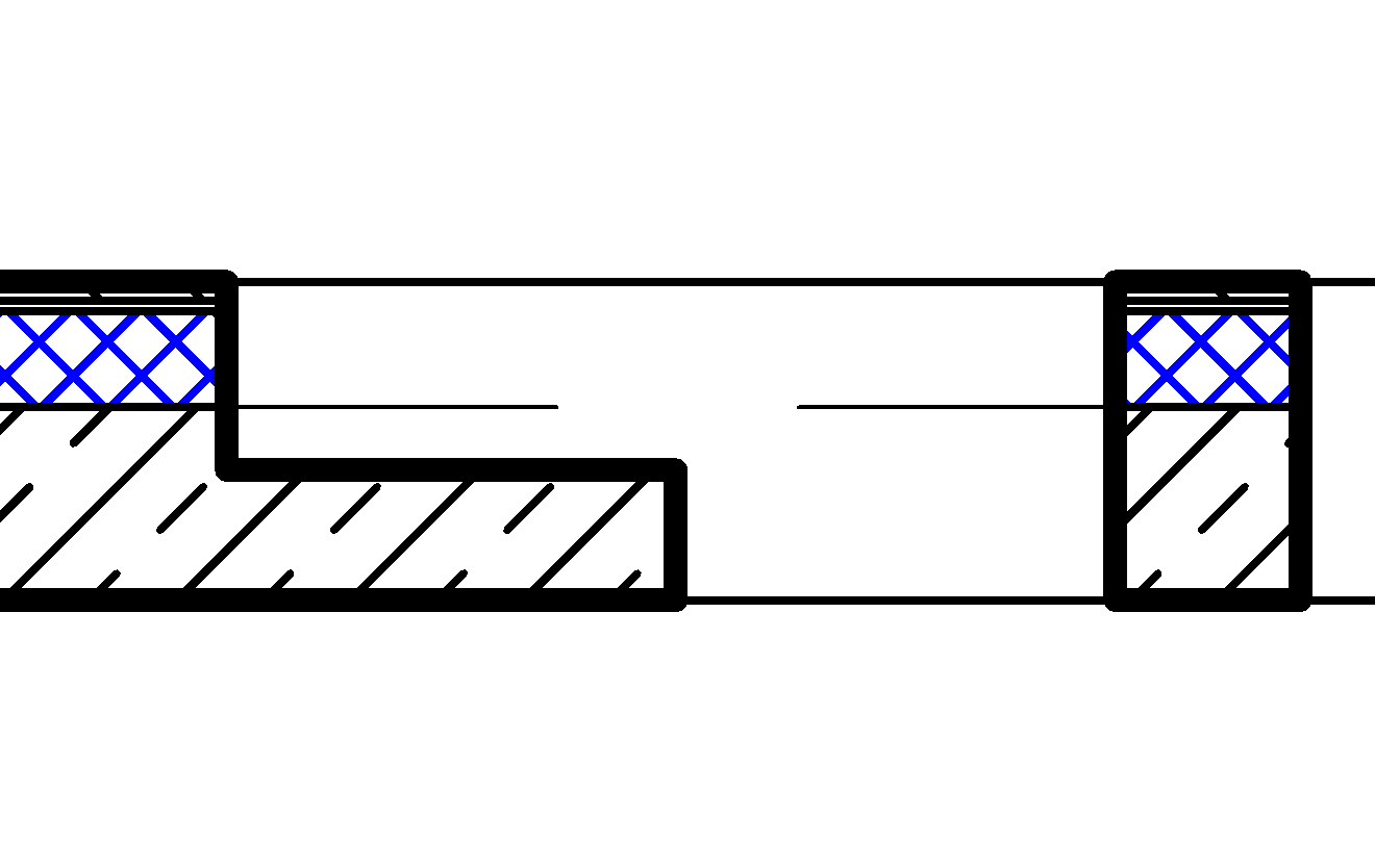

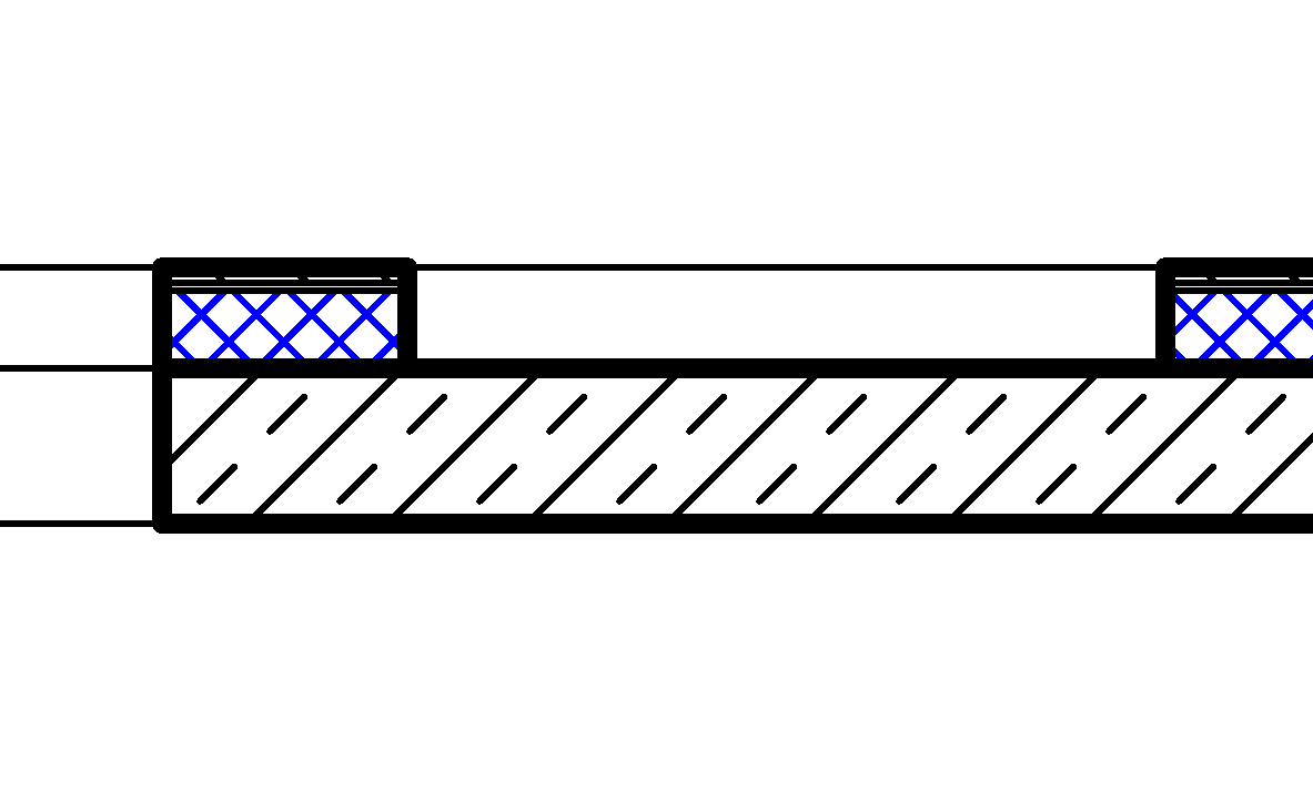

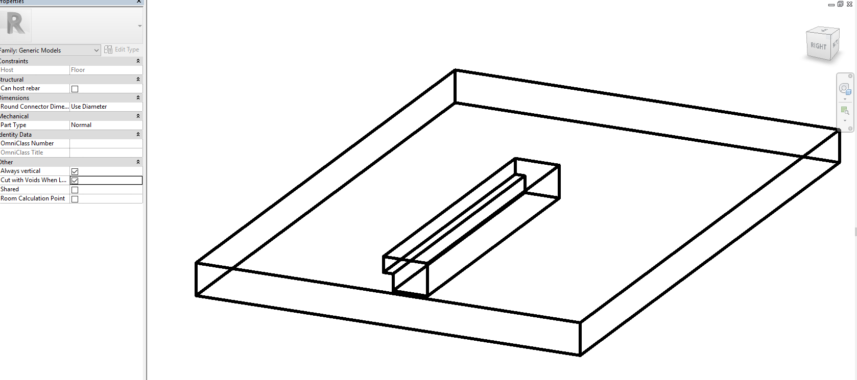

I has a very simple based-floor family with void. When I load it into project, sometimes it cut but sometimes it doesnt. I can not understand why. Please help.

In the view on the far right, your two different floors are not joined like the are on the floor to the left.   Join the two floors.
