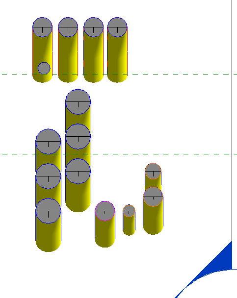

I am trying to create a penetration drawing of some conduit that is coming through the floor at an angle. I set the top to associated level 1' and the bottom to associated level -2" because I only want to see the perfectly vertical conduit, not the angled conduit. Although I can't get rid of the angled portion of the conduit.
Any ideas?
I attached a screen shot of the conduit.
Thanks

Can I assume that you have selected the ones that you don't want to show, right clicked, and selected "Hide in view"?

you can use filters to the view using the "slope" instance parameter: vertical ones show "not computed" in this field.
