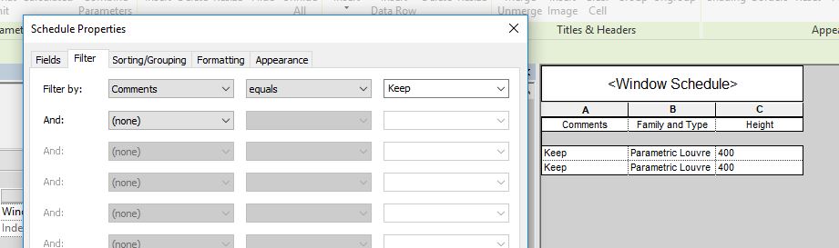

You maight also consider using one of the existing parameters for this.  The attached image shows a schedule using 'Comments' as the filter parameter.

Thank you! I think this "Comment" parameter will be the best solution. By the way, could you suggest a comprehensive Filter and Global parameter tutorials?
