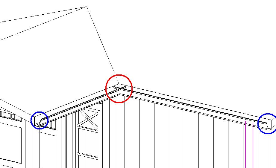

Hi all, I have 3 questions about gutters. See attatched file for info. 1. Is it possible to join gutters in corners? (Red circle in file) FIXED: Redraw my roofs and made sure they where in same plane. 2. Is it possible to add endcaps to gutters? (Blue circles in file) 3. Is it possible to add vertical tubes to gutters? (Purple lines in file) /Jocke Post edited on 2006-06-04 15:33:01

The gutters should join each other, try deleting them and re-doing them. If that doesn't work im not sure what to do on that. You could add end caps to the gutters by creating a simple inplace family. and as far as the down spout, you could also create that as an in place family with the sweap modilfier. Let me know if you need help with any of these.

Thx for the quick answer. I played a little with in place families for the first time. I looked at the tutorials but cant figure out how to use it. I manage to make 1 end cap (generic model) but when I try to copy it I cant make it align right. Do you have a file with gutters with end caps and spouts? Or if you can write an easy tutorial would be great. EDIT: EDIT: I now managed to copy and join my endcaps. It all looks great. THANK YOU! EDIT: /Jocke Post edited on 2006-06-05 02:25:06
