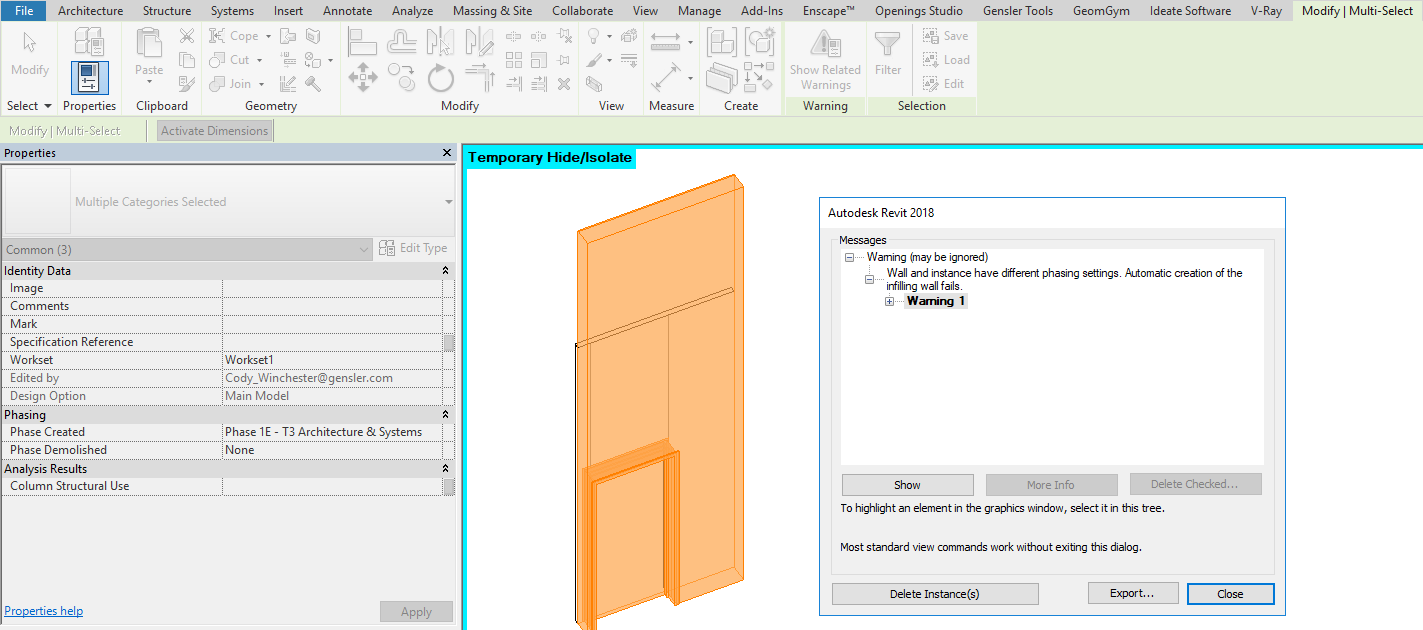

I'm cleaning up some warnings in my project and came across a "Wall and instance have differenct phasing settings. Automatic creation of infilling wall fails." Interrogating the elements I see that all items actually do have all the same phasing settings and therefore there should be not confusion about wall infills not being created. I'm confused as why this would be reported and I cannot fix it. Any ideas on why Revit would possibly report this incorrectly?

Don't be too quick to blame Revit.  I see another wall, I think, behind these elements.

Indeed there is, but all elements visible have the same phasing and their relationships are not impactful. I've attempted removing the other item as well and there is no affect. Rehosting the door also has no effect. My questions still stands. Any other suggestions?

Check the ID of the elements in the warning dialogue and make that you're checking the correct elements.  It may not be the ones that you show.

tim123, that's precisely how I was isolating the elements. I'm not sure why Revit is confused. May the elements previously had phasing and then it was removed and for some reason that made Revit confused and thinking that there is an issue depite the condition being correct. Seems to be a glitch. Not the first time. Oh well. Revit certainly isn't perfect. I will just ignore it for now. Thanks anyway. Cheers.
