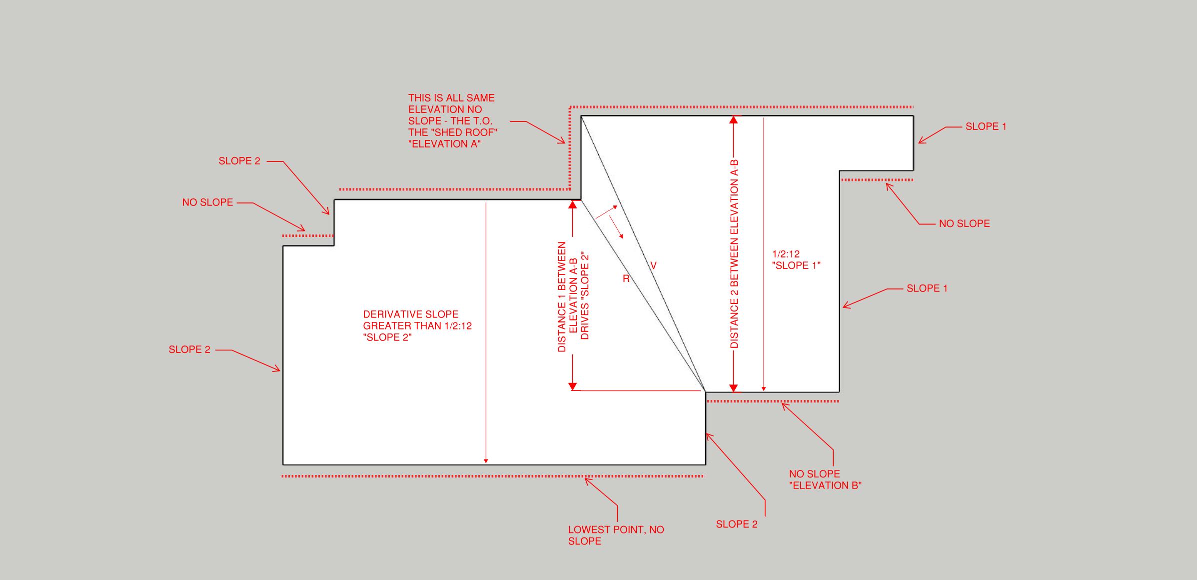

This roof is not that tricky, but too complicated to do by modify subelements and too complicated to do by "define slope". What is the best way to achieve this is revit?
Attached image has all the parameters/notes.

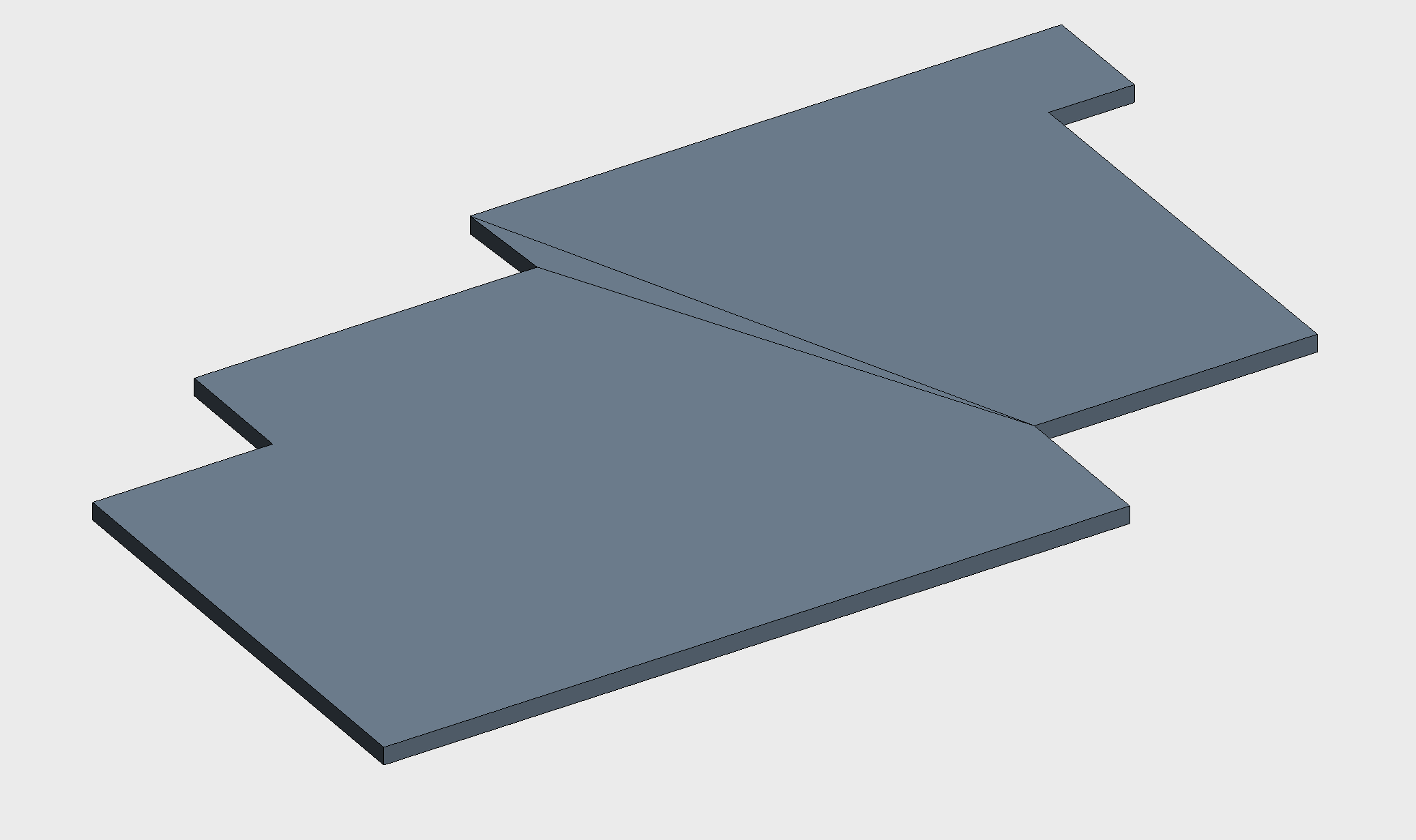

How about by combination of both?
Mon, Sep 24, 2018 at 2:12:05 PM | Tricky? Roof
bmneu
Joined: Mon, Sep 28, 2015
0 Posts
Thank you. This worked!
