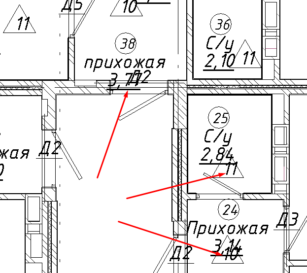

Good day!
We are working on a project with some blocks being mirrors of one another. So let's say block 4 is a mirror of block 7. I completed block 7 and when I load this into Block 4 everything is fine except for: Some tags, marks of windows, floor marks and apartment numbers are overlapping. Is there any way to keep those behaving normally?
Thank you.

By "blocks" I meant building blocks. We have a project consisting of 9-storey 10 buildings (blocks). Apologies for not making  this clear. So when I open Block 4 the Block 7 is linked to the open file. Which means there are no elements in Block 4 file except for the links. The mirrored link of block 7 is going as Block 4 to the printer. The problem however is the tags which start flying.
