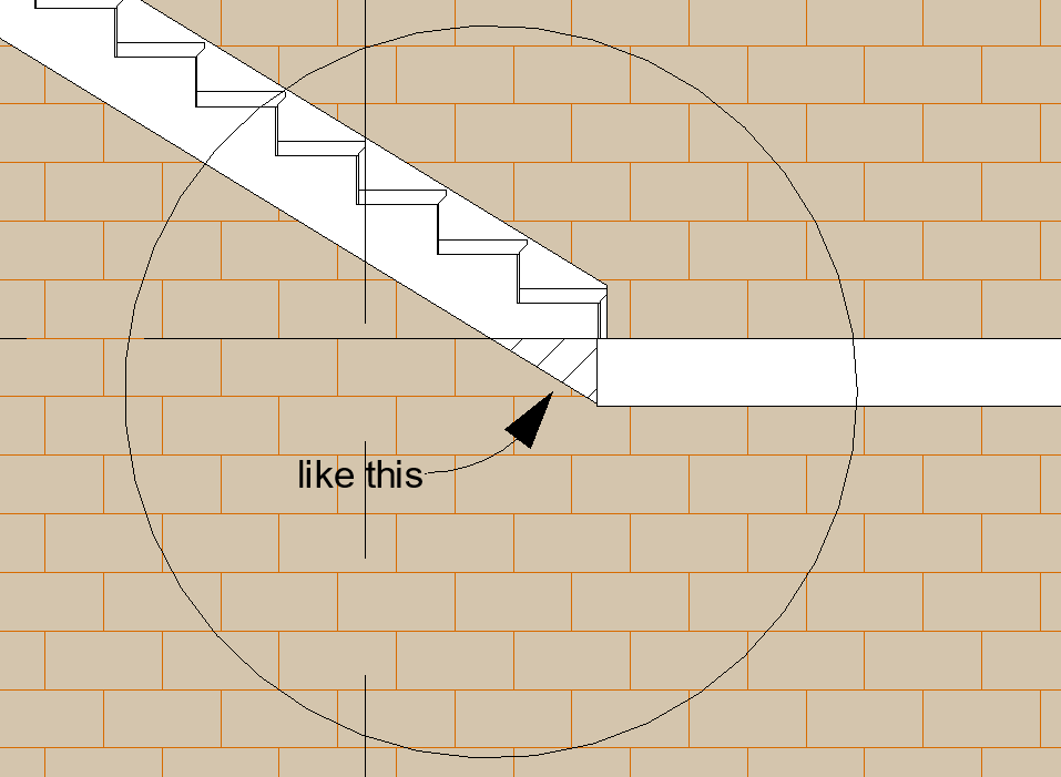

how can i extend stringer below the floor in order to maching it with floor?

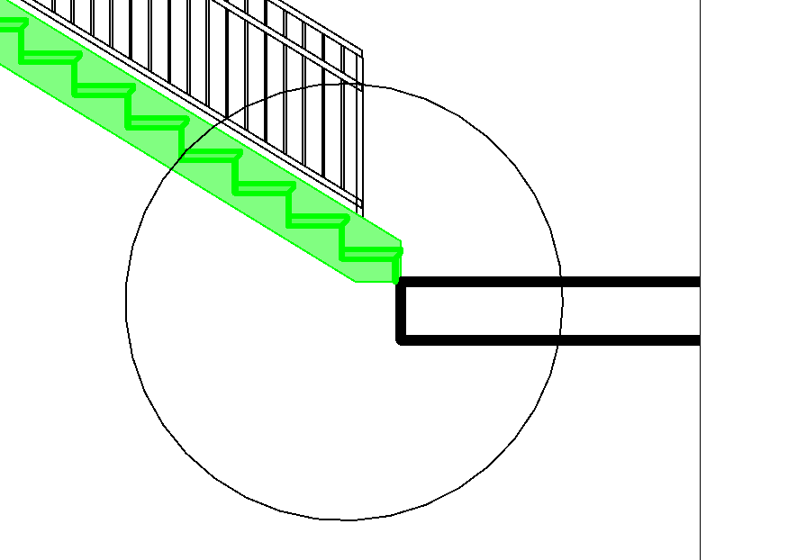

Go to 3D view. Hover mouse over stringer, hit tab to select it and it only ( not whole stair). Options will appear in propoerties to adjust its end cut.

Hi and thanks for replay,my isue is extending stringer below the floor ,which i have don it befor with Revit 2012,i think Revit 2019 might last this ability??!!!
